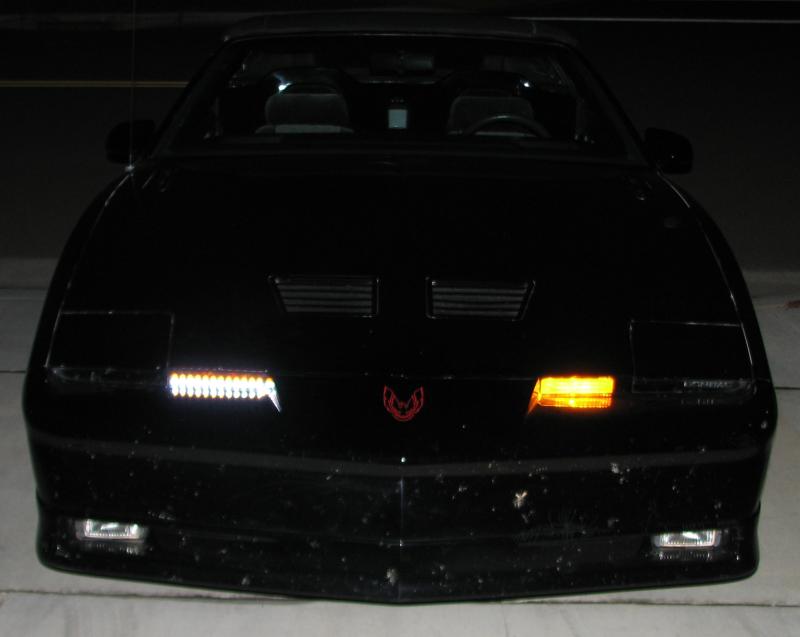

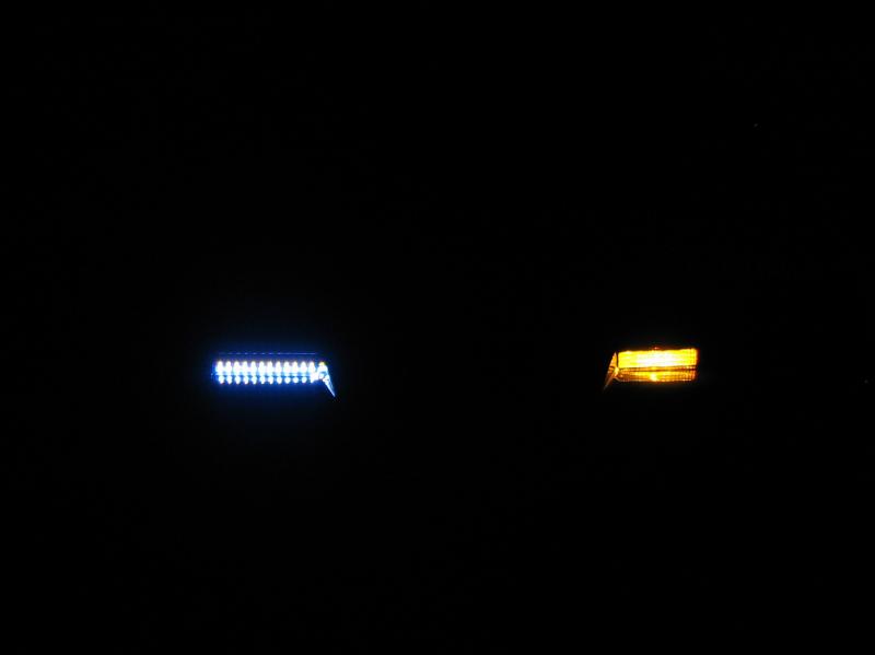

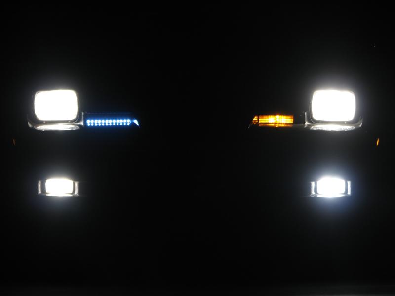

I just recently started a front-end LED conversion. Right now I am prototyping with styles, colors, and number of LEDs. I am placing the LEDs where the front-facing driving/parking lights go. The goal is to make a unit that can easily bolt-in without any modifications being made by the installer, true plug-n-play. My first prototype uses one row of Hyper White for driving/parking and another row on top of that in amber for the turn signal. Unfortunatly the amber is not anywhere near bright enough to be used effectively so I will have to play around for the right combination.
The problem I ran into during wiring was I accidentally joined the parking light wire with the flasher wire. I put it back to how it is supposed to be but now my right turn signal does not work (even if I put the original incandescent bulb back). On my instrument cluster, the right turn signal is always on if I have my parking or headlights on. My hazards and left turn signal work as they should. If I signal right without making the switch click into place, I can signal right, but if I click the switch into place, the right signal just stays on.
The pictures below are of the first prototype. In the end, my goal is to sell the kits for around $80. Please do let me know if you are interested, I am trying to have all testing done by mid-summer. So far, color choices are Hyper White (the all-around preferred color), Natural White (to match stock headlight/fog-light color, and Amber (preliminary tests show these would be ineffective for practical use but may look nice for show purpose.)
I have not done too much research, so I am not sure if similar products are out there already. If there are and they are better, I am sorry.

Stephen: Sorry, I did not check for 50-state-legal, I do know in California the front aiming turn signals have to be either White or Amber, and any rear aiming turn signals have to be either Red or Amber.
camaronewbie: Actually these are SMD, but thank you much for the advice. I was thinking of a 1-white 2-amber rows setup, that might put enough amber in the mix, I was also thinking of having all 3 rows amber and having the signal from the flasher flash all 3 rows when you want to signal. I am going to test it with all 3 rows amber and see what happens, but so far I am very dissapointed with how dim these SMD Amber lights are, as you can see, the Super Whites are VERY bright. I used a fast shutter speed, so it doesn't really look that bright in the pix. In the end, I have to make sure they can be seen from at least 100ft away on a bright summer day.

Believe me, I think it looks weird too, but to be legal, it has to meet minimum luminance as well, and I really don't think that even having all 3 rows amber will meet that, but I will try it before removing that option.
