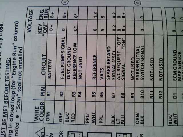

I got it done but I dont know if it works or not. Your pictures are different then my set up since I got TBI

Ill try and get some pics I dont know how they will turn out but my ECM has 2 instead of three connectors I cut the Vats wire hooked it and did the ground and power and it still aint working.

is it cranking? if not find the starter enable relay under the dash on the driver side. did u use a toggle switch after all? if so check if your wiring is routed the right way

It should be under the kick panel behind the square of goo. If it isn't there it could have been moved as it was on my car.

This is the diagram of my ECM connectors and what I went off of. They are out of my shop manual.
Attached Thumbnails VATS ?-0621101453-01.jpg   VATS ?-0621101453-02.jpg   VATS ?-0621101453-05.jpg

ok you need your power cable on the C14 and the vats its on the B6 check those two wires... try wiring the bypass module by itself without the switch first to check that it works.... also did u find the starter enable relay??? u need to bypass that one also to be able to crank the engine. its on the driver side under the dash closed to the fuse box, its usually wrapped around electrical tape once u find it take the relay of and put a wire from one of the thick wires to the other thick wire (you should have two thin and two thick wires)

Ok thanks man so I did have it wired right. Since I am going to put a switch to the starter I should be all good then when its nice out here since its been storming and humid like crazy I'll get out and do that to make sure its all good and everything. Thanks so much.
