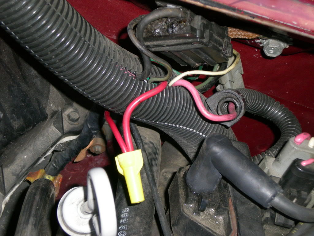

OK, my grey connector is not melted but the black connector looks like this. I copied this from another post. My grey connector (where this shows two red wires connected looks good). Should the burnt black connector look this way?

Ahaa! After further inspection the inside of the grey connector is BURNT. Will post the results in a few!

Wire nut... It's probably not related to your problem, but I'd eliminate that wire nut. A length of heat shrink tubing, some solder, and an iron would clean that up in a hurry.

Ok, took longer to update my cell phone software than to fix the bad connector! Thank you James for your knowledge and your built in search engine! That was the exact fix! I'm posting a couple of pics from my cell phone. Be sure you take your grey connector apart to check for damage! This website ROCKS! I'm having trouble posting my pics. I'll try again later.

Ok, see if I can post a couple of pictures of the culprit connector![ATTACH]Blower Motor-Low and Medium only-bad-grey-connector.jpg
Blower Motor-Low and Medium only-bad-grey-connector-2.jpg[/ATTACH]
Here are two pictures of the BAD GREY connector! If you have a blower motor that will NOT come on on high, check this grey connector, it is more than likely fried!
Once again, THANKS TO JamesC guru of Third Gen.
