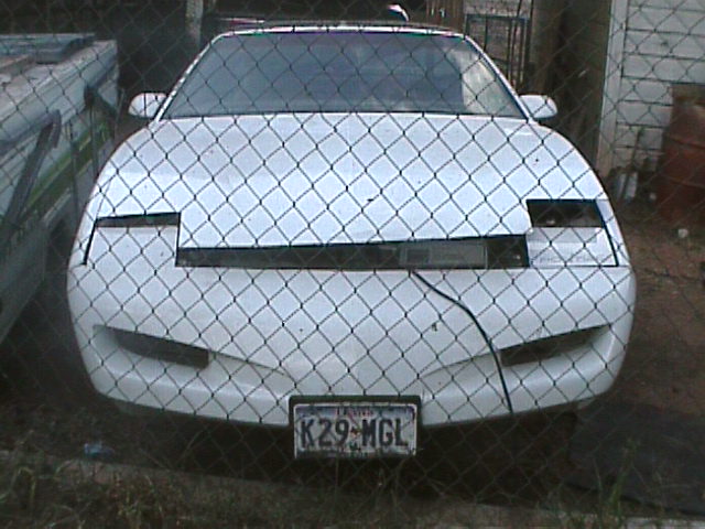

Thanks for any and all suggestions given to me. I finally found the problem. The contacts inside the socket were bent and only made contact just as starting to push the bulb in. I cleaned and rebent and now they work. The right side will need a new socket though. The light still goes out with a slight wiggle. Now brake lights and motor running and it will be ready for inspection. I will do other work first but it would pass.
