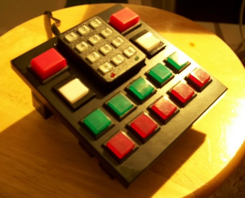

What I have and plan to do...
I do not want to use a key to unlock wheel, or start the car.
I got the ECM / VATs covered....
Will removing the key cylinder solve the problem of the wheel locking?
Can I bypass the ignition switch at the bottom of the column?
I will have an alarm remote start (1 way of starting it)
The other method, I want to use a on / off button (to activate ignition) which powers a keypad, if you enter the right code, it allows access to start the car via 2dn momentary button (starter)... The keypad is a DEI Alarm accessory.
Here is a pic...
the top left red button would be for ignition, which would turn on the keypad to the right... if correct code is entered, then it allows you to use the big red button on the right to start the engine... (2 white switches are for windows, red and green for disco lights, smoke, etc
Any advice or notes would be greatly appreciated...

i would entirely remove the locking mechanism from the column.

you have to remove the lock that engages the lock plate. I would replace the ignition switch with an 80amp relay.
You will need to remove all the wires that go to Ign switch and rewire them through your switch panel ( or pref relays )

To remove the locking function of the wheel, you need to remove either the lock plate or the lock pin. Both are located in the column. The lock plate is the easier of the 2 to remove since you have to take it out to get the pin out, IIRC. I would still remove the key cylinder and smooth the column where it was and paint over it.
As for the pushbutton start, all the wires you need are at the bottom of the column. Use relays to make the connections, control the relays from your buttons.
Also, make sure you wire in a cutoff relay that shuts off whichever button you are using to actually engage the starter. That way if the button is accidentally pressed while the engine is running so you don't damage your starter or flexplate.

AFAIK the lock plate needs to be in place to hold other stuff in. Best bet would be to remove the pin that holds into the slots in the plate.. OR you can modify the lockplate and remove the teeth from it and re-install it and everything will work the way it should without locking the wheel.
