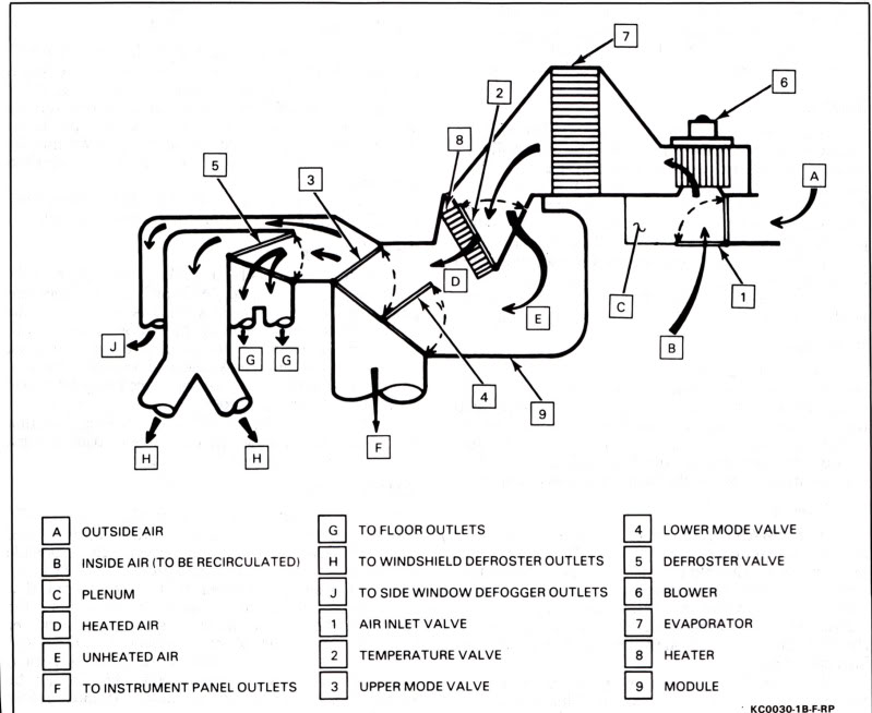

first of all, the problem with the fan motor not kicking on could be your switch in the dash
secondly, when you are feeling for air coming out different places, check the defroster vents first. If you have a lack of vacuum, all the air will com out the defrosters

ok, you have a vacumm problem.. the easiest place to check is the servo under the dash, passenger side, by the kick panel
You need to check every vacuum line, everywhere...

Ok whats the easiest way to check for that and is it just a black line or is it a diffrent color. And as for the fan could it be the blower speed selector?
