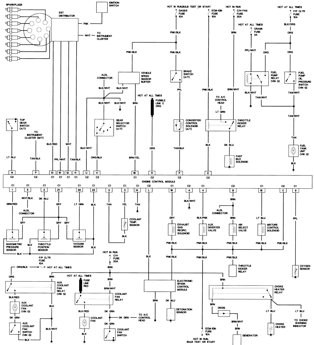

I've been trying to find them all using these diagrams but I don't know if I'm stupid or what but I can hardly match any of these to the diagraam.
http://www.austinthirdgen.org/mkport...ine_wiring.gif
http://www.austinthirdgen.org/mkport..._continued.gif
anyone see anything familiar? This sucks wiring always gives me a headache.
In the meantime I'll keep screwing around with these diagraams..thanks for any future help.
