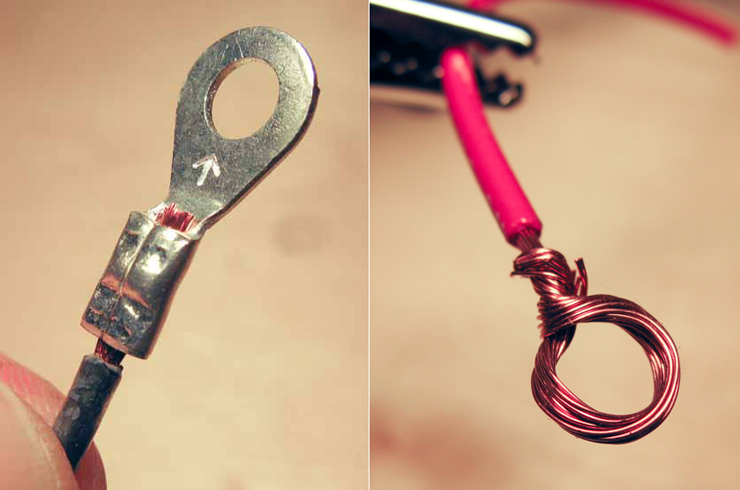

I would like to note that you WILL NOT be able to directly plug in a new cigarette lighter from your local autoparts stores.
The stock cigarette lighter is terrible, and in order to fit a new style lighter, you need to cut the lighter plug off, and buy some blade terminal connectors and have a soldering iron handy.
The stock cigarette light looks something like this:
Buy some of these, and remove the yellow jacket off of it by cutting it off, but leave the crimping part:
This is the wrong style connector, but for demo purposes, this is what it looked like when I did it (left, but blade connector), then I soldered the crimped area to the wire AFTER it was crimped. (Ignore the right side picture)
And for the life of me, I cannot find an image of a new style cigarette lighter. But anyhow, I hope this leads you in the right direction.
