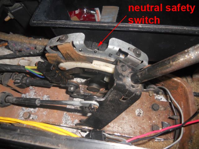

I have an 86 irocz reverse lights wont work but for a split second when i go to put it in reverse i thought maybe the bulbs were getting close to burning out so i replaced them same problem exist. Anybody know what to do?

Your neutral safety switch needs to be adjusted. It's attached to the side of the shift mechanism.

Not looking at it right now so how do i adjust it?

Take off the shift plate and it'll be obvious.

attached to side of shifter mech ,has 6 wire connector going to it

stupid question but how do i adjust it?

Loosen the two or three screws that fasten the switch to the shifter and rotate the switch fore/aft until the back-up lights stay on. Before you button it up, confirm that the engine cranks only in P and N and not in any other range.

Heres what mine looks like. Im guessing your talking bout the silver part that attaches the plug to the the rest of the shifter assembly?
(The yellow wires and black and red are ran for switches so ignore those)

And god said let there be light!!!! thanks paulo you saved me a huge headache and having to waste money taken it in to be looked at
