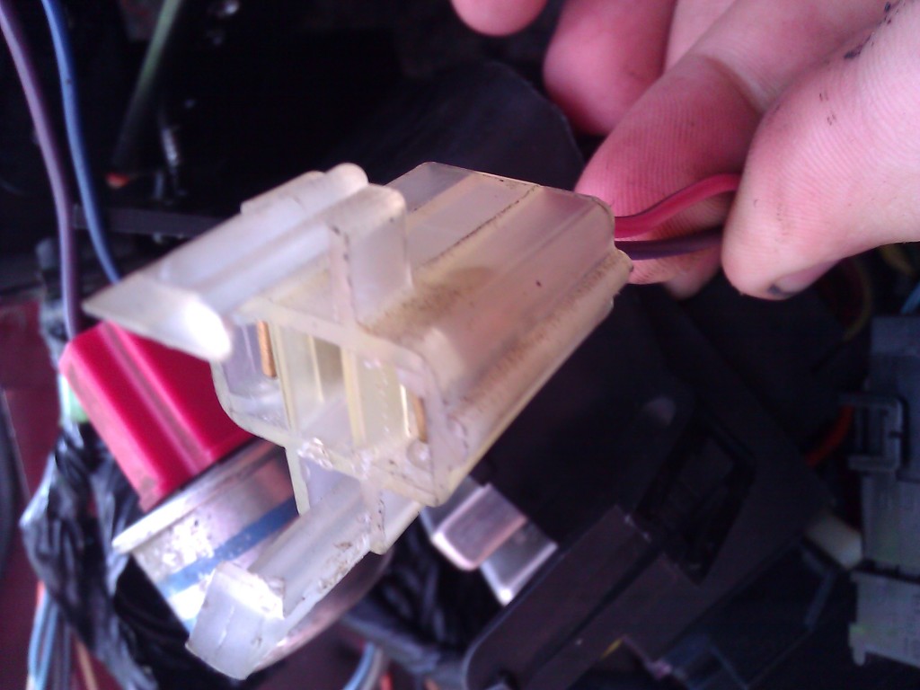

I swapped a "new" dash into my 1990 Camaro. My steering column no longer has cruise control, but I don't think this is for the cruise control. Does anyone know what it is or where it goes? I cant find it in any diagrams or if I'm just looking over it My car wont start, I bypassed the VATS and that system is happy. I'm hopping this is the problem. I'm about to check if the ECM is receiving power though the connector. THANKS!
The connector is under the dash, it has a pink/black wire and a purple wire.

looks like i brake switch plug. is it Hot?

I don't believe its for the brakes. There is a white switch that has two connectors on it for the brakes. Is there more than that?

i'm not sure off hand about your car but mine had 2 switches one for the brake light and computer/lock up input and one for the cruse control. but i don't think that would be your reason for the car not starting.

To answer your origional question. the connector you took a picture of plugs into the switch that shuts the cruise control off when you hit the brakes. it is a white switch with a vacuum line coming out of it right next to the three wire brake switch. Just checked it out on my 92 with the auto.
