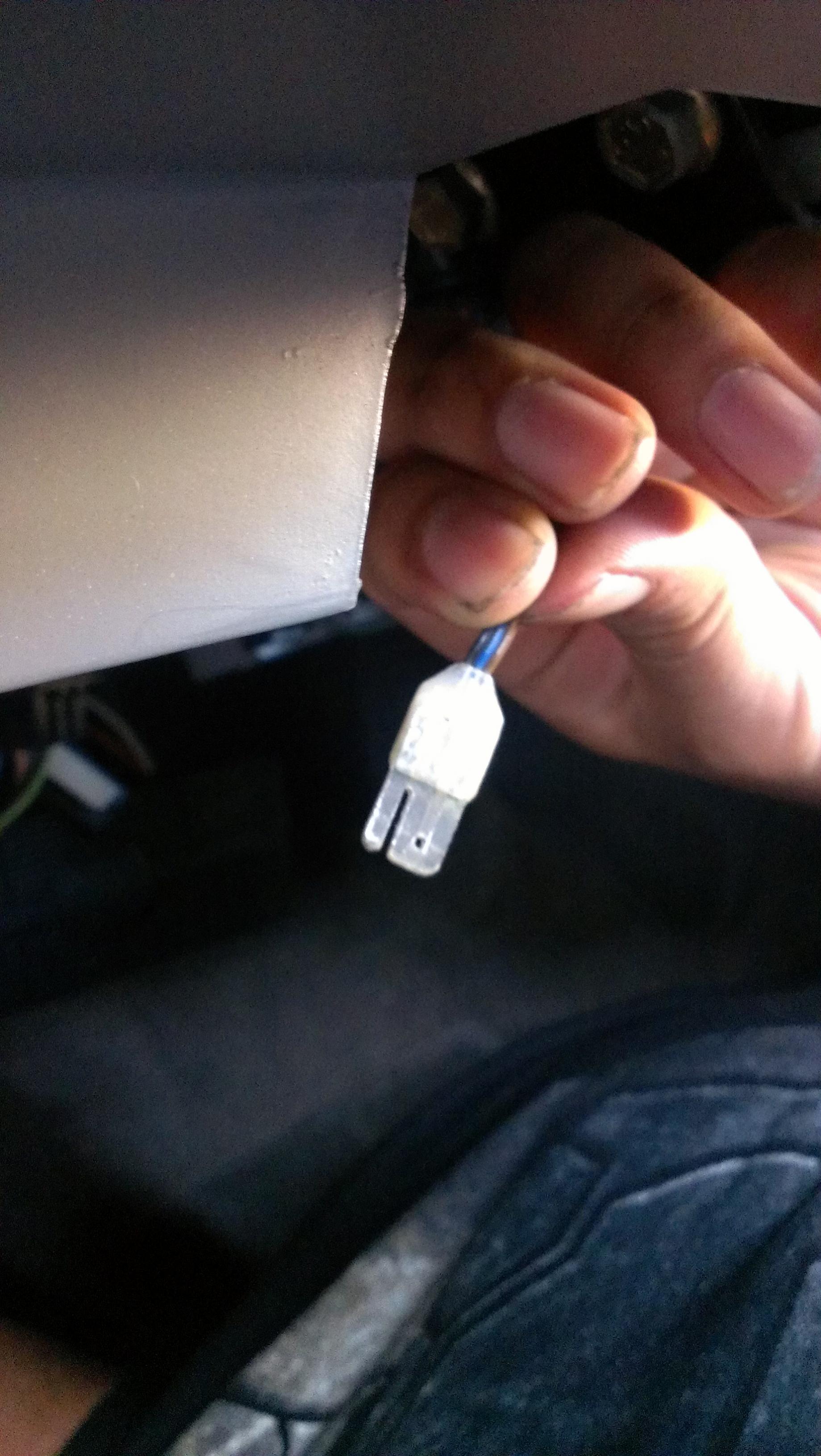

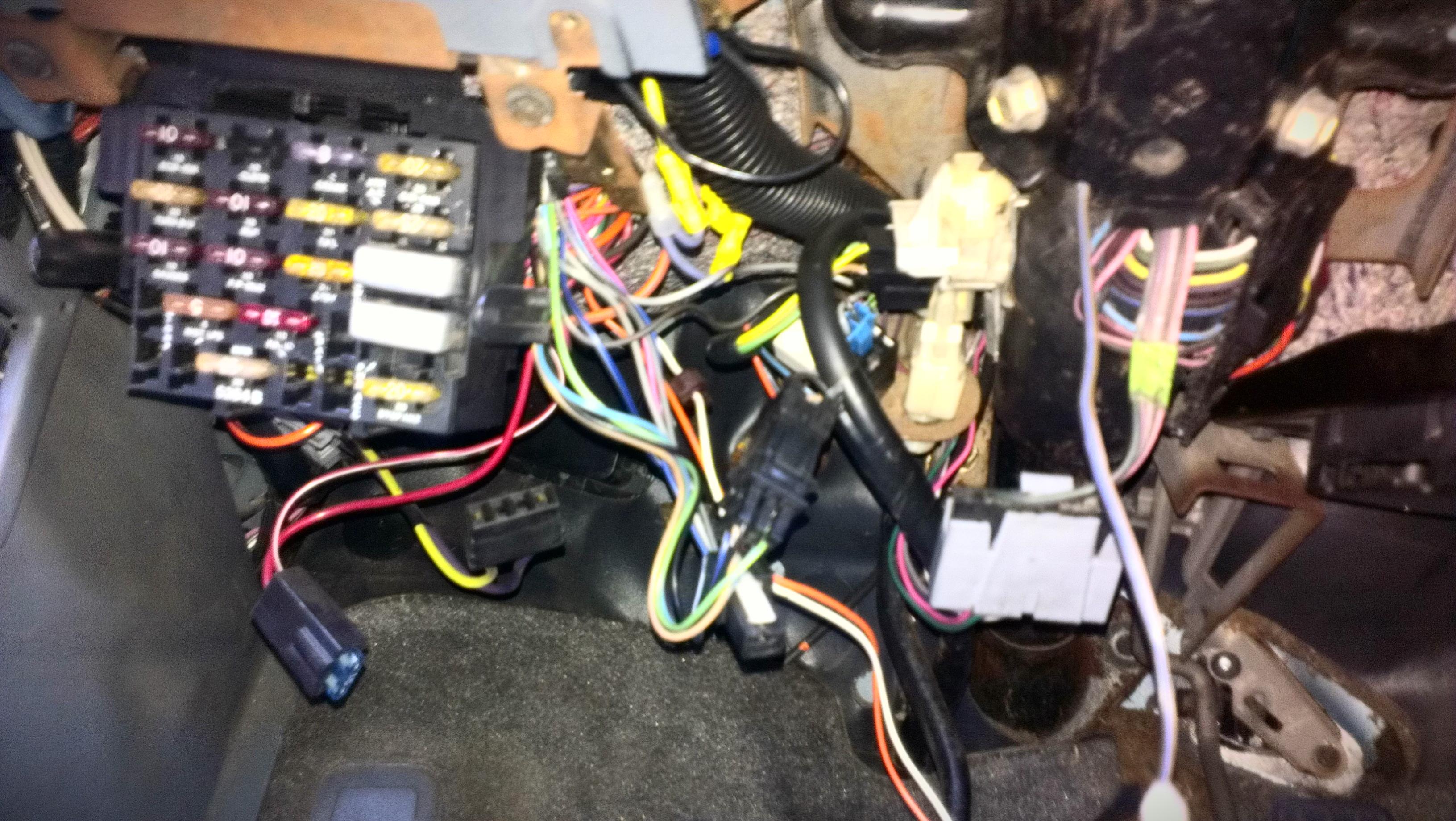

I have trying to figure out where to plug my signal lever in so my cruise control will work. I have searched everywhere but to no avail. I was wondering if anybody could help me find where since it's impossible on my own. I attached a picture of the end I'm trying to plug in and a pic of the area down where the pedals are. Sorry for the second pic being so confusing since there's wires everywhere. If anybody has any ideas or knows where, I would appreciate it and if possible a pic of where on their car the connection happens at. Thanks

Not sure if you have the same car as I, but there should be a small rectangular receptacle with three wires connecting to it (blue, green, and pink with a black strip). The three wires go through the firewall along the hose for cruise control to the cruise control transducer/unit. It should fit in only one direction. Hope this helps. Let me know what happens.

Thanks for the pic. I have searched online and couldn't get anything that really helped, but this one did the job. It's all set and working perfectly. Thanks again

With so many wires and everything I never would have guessed that it went into that piece. Thanks for the help, everything's all set and working. Also your cars set up was dead on thanks again.
