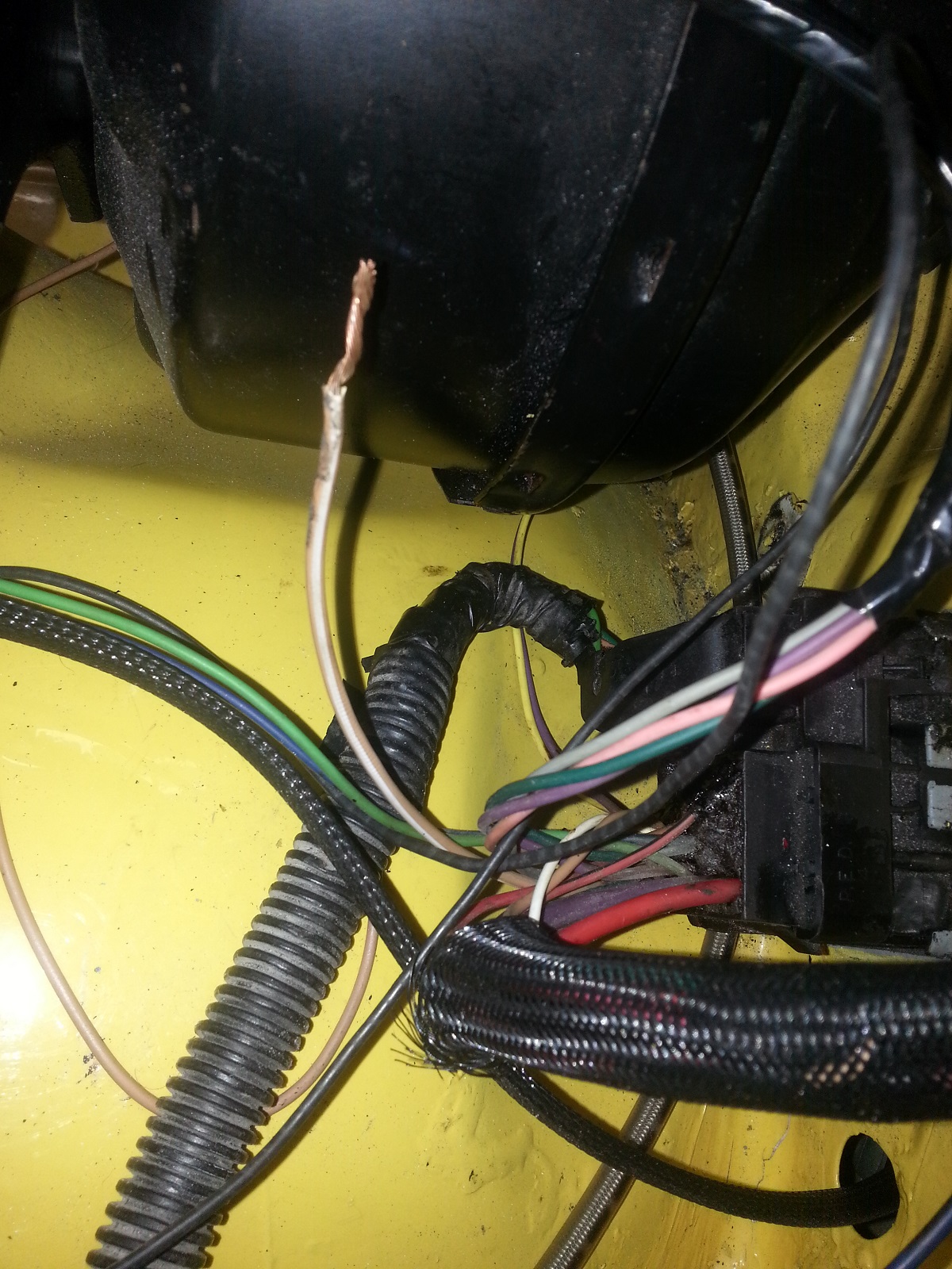

can you tell me where these go? thanks

First one on first post is for the knock sensor

ok thanks tbrays98, and I know what the tan wire is for, now for the second post?

Last one (yellow & black) is coolant temp sensor

1) Depends on wire color, dk blu Knock. Dk Grn, thermal switch for fan relay
2) Tan/wht can be a number of things, you need to find a pin location. If its 18ga, then its either brake warning switch or fan relay fuse. 12ga, fuel pump. For your 89, Id wager its the brake warning
3) Left washer tank motor Right back-up lights switch connector
4) Wiper motor lower connector
5) CTS

the tan and white is fuel, and what Is cts? dumb *** at wiring :[ thanks Pocket that helps me so much, appreciate all you guys helping me.
