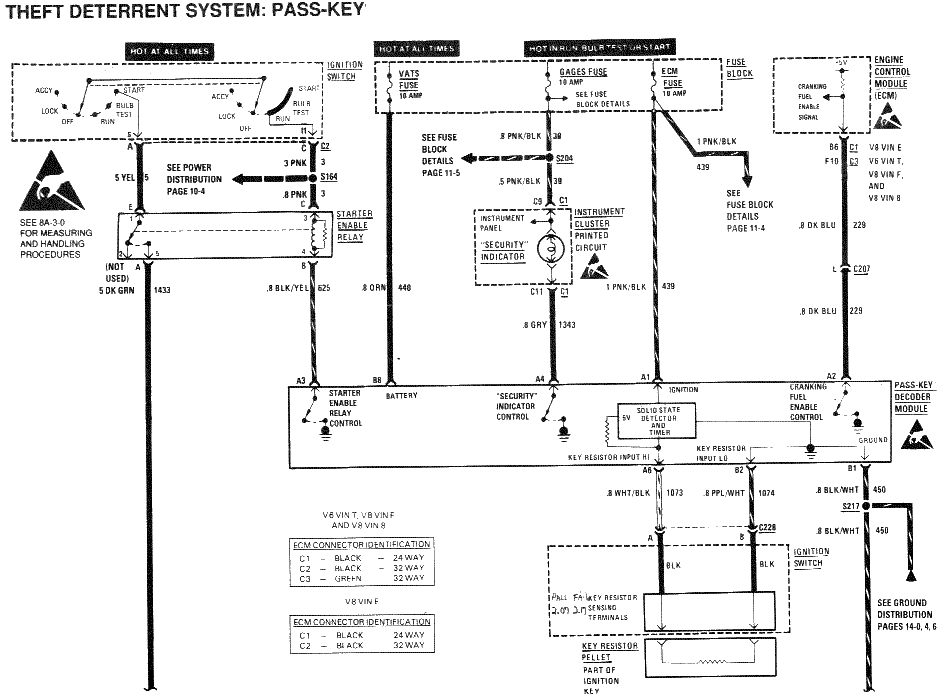

I looked up starter enable relay and found a picture on thirdgen of what I think it is. Is the picture on BigMyke's post (9-20-2011) correct?
https://www.thirdgen.org/forums/elec...le-vats-3.html
On my car, the plug/connection that is circled in BigMyke's post picture is just hanging below the fuse box. I have looked around to see if I could find what or where it connects to, but I do not see anything. Do you have a picture of what this connects to? Or where do I need to look?

the relay was bypassed in mykes picture, the relay plug is circled and just NorthE of the circle, you can see the starter (yel) and relay (grn) tied with a barrel connector.

To add, that connector plugs into a relay. Iirc, the vats relay was behind the kick panel (where the hood release is), though, don't quote me on that.
