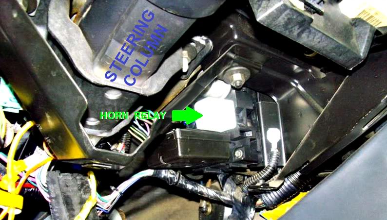

HORN:
Connect a voltmeter to pin J of the horn relay, (you can remove the relay and probe the socket which might make it easier) what is the reading on the voltmeter?
Now press the horn button on the steering wheel, now what is the reading on the voltmeter?
To access the Horn Relay remove the knee bolster.
The relay is to the right of the steering column.

HORN:
