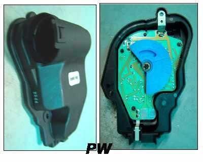

Need help with wiper fluid pump
Hi ever since I bought my firebird one of the 2 or 3 things wrong with it was it was unable to spray washer fluid. I replace the pump but it did nothing so I took it to a mechanic and after throwing out $120 the mechanic told me the wiper motor cover or what ever the **** this thing is
Was broken (my fault) they told me they can't find one. Can anyone tell me what this parts is actually called and how much it would cost to replace

wiper motor cover..... and good luck

Let’s say you can’t find a working cover.
You can install a switch to activate the washer pump.
You can even connect it thru a timer so you can merely touch the button and the washer pump stays on for a few seconds.
