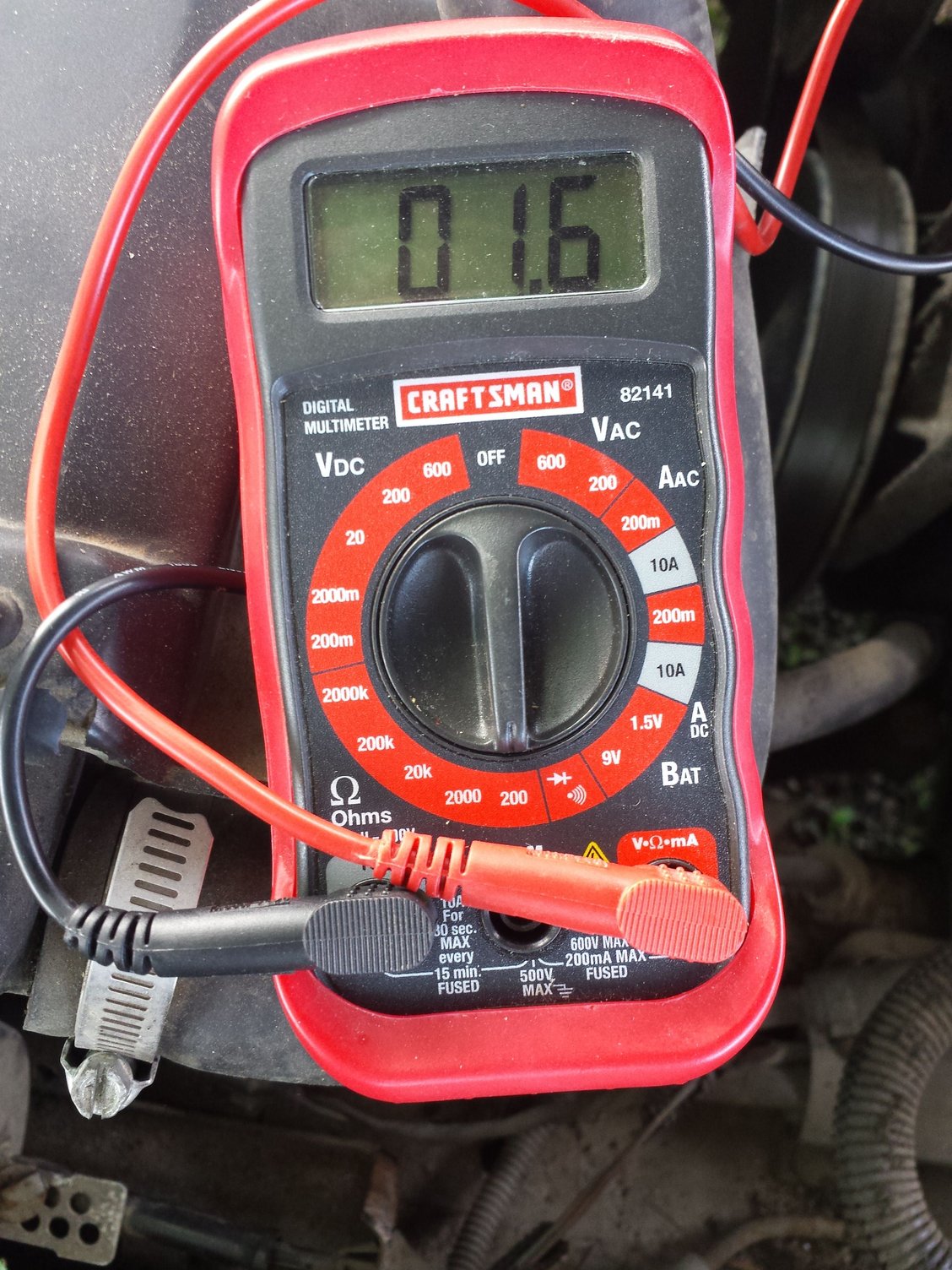

check your fuel pressure and ohm your injectors !

Re: injectors aren't firing

is this tbi, tpi or a v6 ?
tbi is 2.5 Ohms
tpi 16 1/2-18 1/2

Sounds like the low impedance/shorted injectors are shutting down the injector driver.

Iirc tbi injectors are 2.5 ohms . Regardless unless you have a custom tune and the 65#hr injectors you engine will run lean. Read the testing procedures on the other thread. I would still eliminate the ECM is getting a drp , vats signal is getting to the ECM, both injectors unplugged and a noid light is used to test injector pulse.
