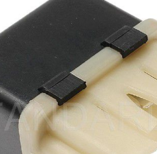

I am using the stock 1987 (new) relay for the fan on the left side.
When I start the car in the morning the fan comes on right away.
I have replaced the CTS, I have changed the ECM, I have changed the memcal
The prom is programed to come on at 190 off at 186.
I have checked the wire for shorts, there are none.
I turn the key on and have 12 volts at the relay but the fan doesn't start until I start the motor.
I am lost on this one.
Anyone have some input?
