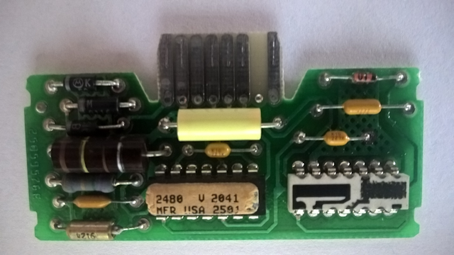

Seems like there's ALOT of people on these forums that have defective tachs...
Would there be interest in a complete all new PCB, all new electronic parts (assuming I can find some LM1819 chips... otherwise I'd have to have a functional "core" one to re-use) with GM's crappy design problems fixed?
You would have to send me your old defective PCB in any case, so I could retrieve the plug-in connector pieces off of it; but no other parts would be re-used. All new resistors of a CORRECT and ADEQUATE power dissipation rating so they wouldn't burn up, all new caps, new ICs if I can find them, new bare board of a completely different design but all the same connections, pre-calibrated, switchable among the various cyl #s. You'd just assemble it to your existing meter, which hardly ever goes bad.
No idea what the price point would be; let's just say for the sake of argument, $100. Who would ACTUALLY BUY one at that price? Keeping in mind the old saying, "money talks, BS walks"... I don't want to hear a bunch of P&Ming about "can't afford it", if that's all you're gonna do then just keep it to yerself... if ya wanna play, ya gotta pay. What about $50? $25? the more of you guys that commit to buy up front, the less I'd have to charge.
I have a 82-88 or so Camaro one as my example. No idea how different the ones for Firebirds are, or for the later model cars. If somebody can send me non-working boards for those I'll be able to know what I can do about them.
Again, no fixed point where the price would end up yet, just gauging interest.

What I propose to do is to make a completely new PCB that replaces the old, using a microprocessor to drive the meter instead of a definite-purpose chip. I think (not completely sure yet) that for Camaro at least, which are the ones I'm familiar with, that I can make one board with all the components that will plug into the place where the later-model version plugs into the cluster backplane; and then make an adapter board to replace the one that the early-model uses, which is much larger and bolts to the back of the meter, with a plug to plug the other into. Cheeeeeeeeper to do it that way than a complete other design.
Here's the early-model board. Some of the holes in it are where the meter attaches, some are where it attaches to the cluster, the screws are where the flex circuit plugs onto it.
Buying PCBs out of China is REAL scary. There's NO TELLING what you're going to get, or when, or what you're going to do if something goes wrong. Been there, done that. No way I would go that way no matter how cheeeeep they say it is. A European or US supplier would be much more predictable.
The attachment is the later-model version that Amillionoh7 sent me. Note that the components on the 2 are the same; they only differ mechanically.

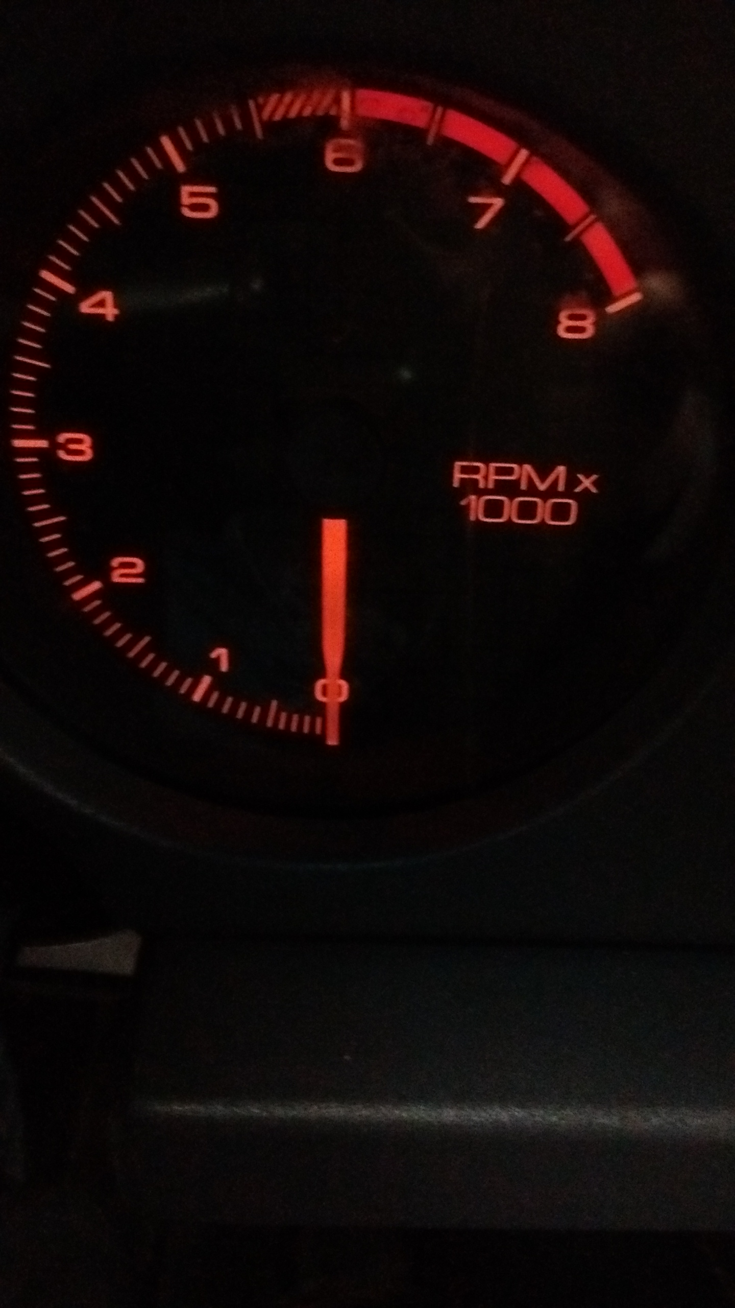

My tachometer reads way too high.
Other than that I am keen

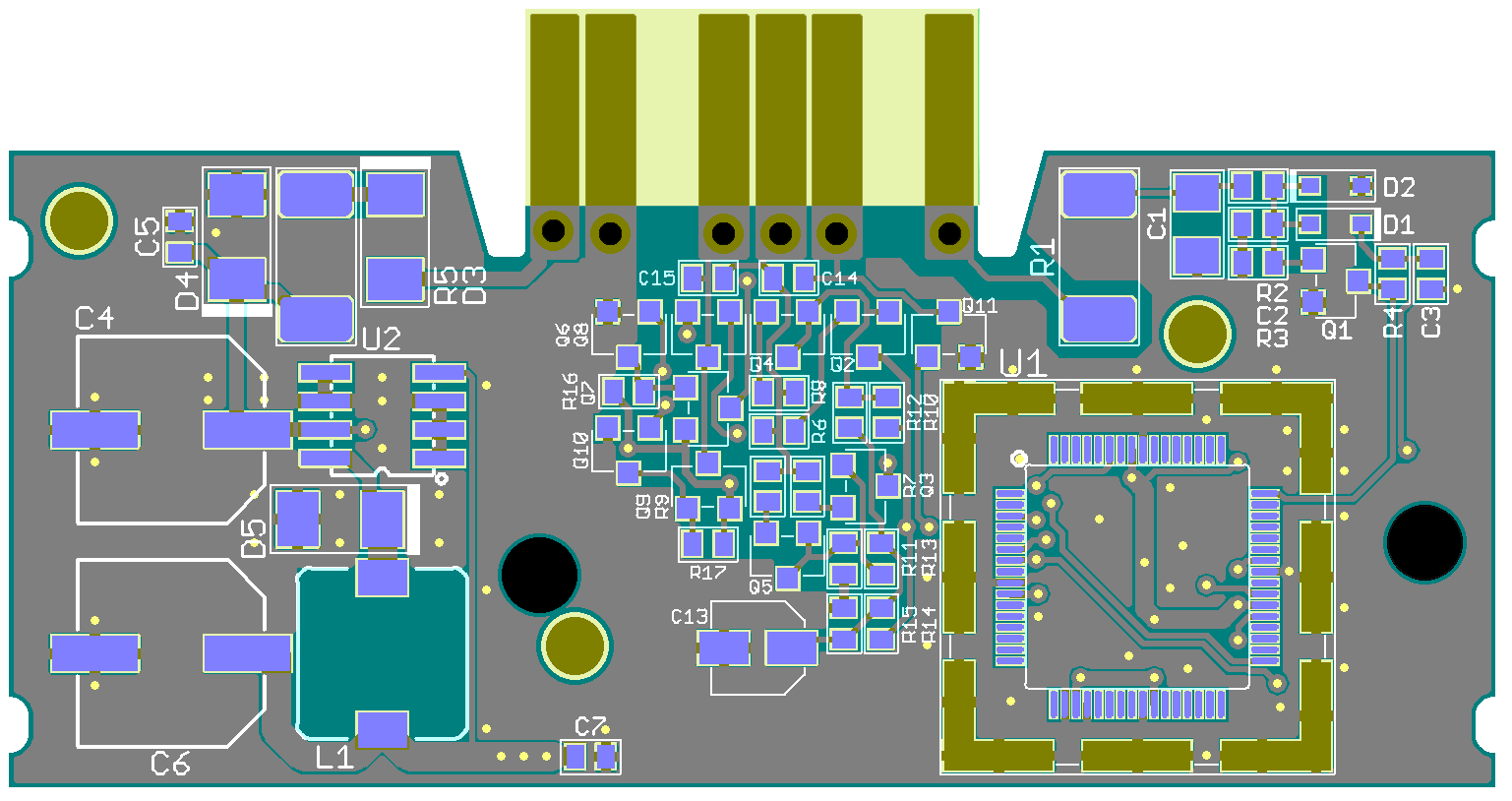

I'll have a few circuit boards in a week or 2; don't know when I'll get the time to assemble them, probably another week. I've got started on the software but until I have hardware to put it in it's hard to say how long it will take to get that into a usable state.
Here's an image of what the board will look like. The main dimension is 2.625" x 1.125", plus the connector part extends .250" beyond that. To give you an idea of the scale of things, the connector fingers at the top, which plug into a card-edge connector, are on .100" centers.
This is the top side; there's a few parts on the bottom too.
