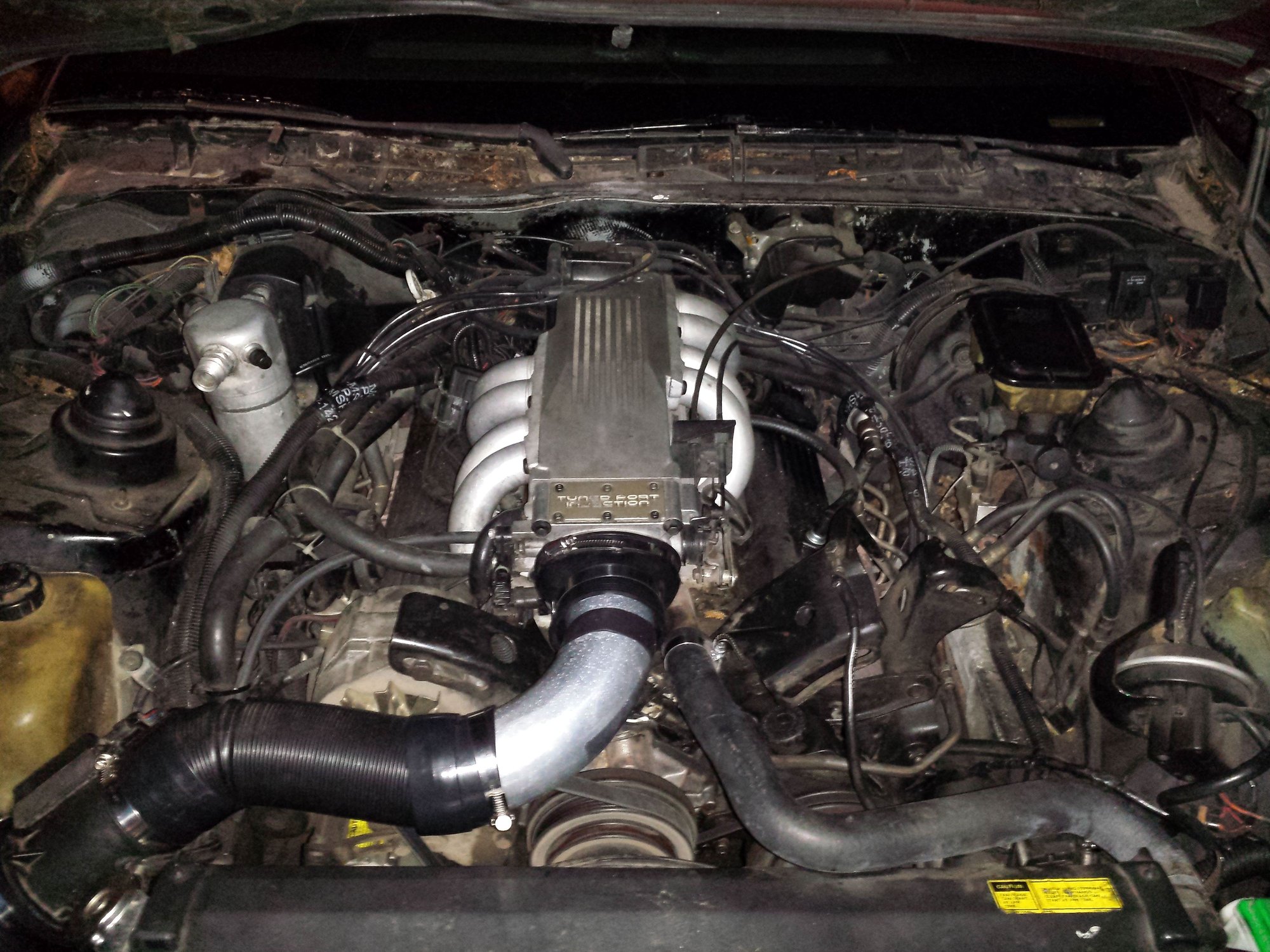

86 T/A TPI
Changed MAF. Changed Maf power relay. Changed Maf burn off relay. Changed maf a SECOND time. Still throwing code 33 and 36. Now, after replacing new duralast maf with ANOTHER new duralast maf, noticed slightly different behavior, with first maf it would stumble on throttle application, with replacement maf it revs fine just won't stay running and runs richer than Trump. I'm guessing I need to hunt down another MAF do you guys agree?

Correction....with MAF connected I get no codes but runs like turd. Also, any suggestions on brand?

Also your cold air intake setup isn't ideal. Heck, it's down right bad for the car.
The MAF needs non turbulent air, aka through a strait section of pipe, to give accurate readings.
Put the stock setup on and see where it gets you........

I would but I don't have it...bought it with a ripped up stock snorkel attached to pipe pictured...chopped the pipe to make it fit. Dude that had it botched it up pretty bad....fan switch where the sender was supposed to go jumper wire from batt to burnt up fan relay pigtail etc
See what you can do about replacing the bendy party of the tube with a strait section, put the MAF in the middle (similar to a stock setup).
Turbulant air will just kill the MAFs ability to read accurately

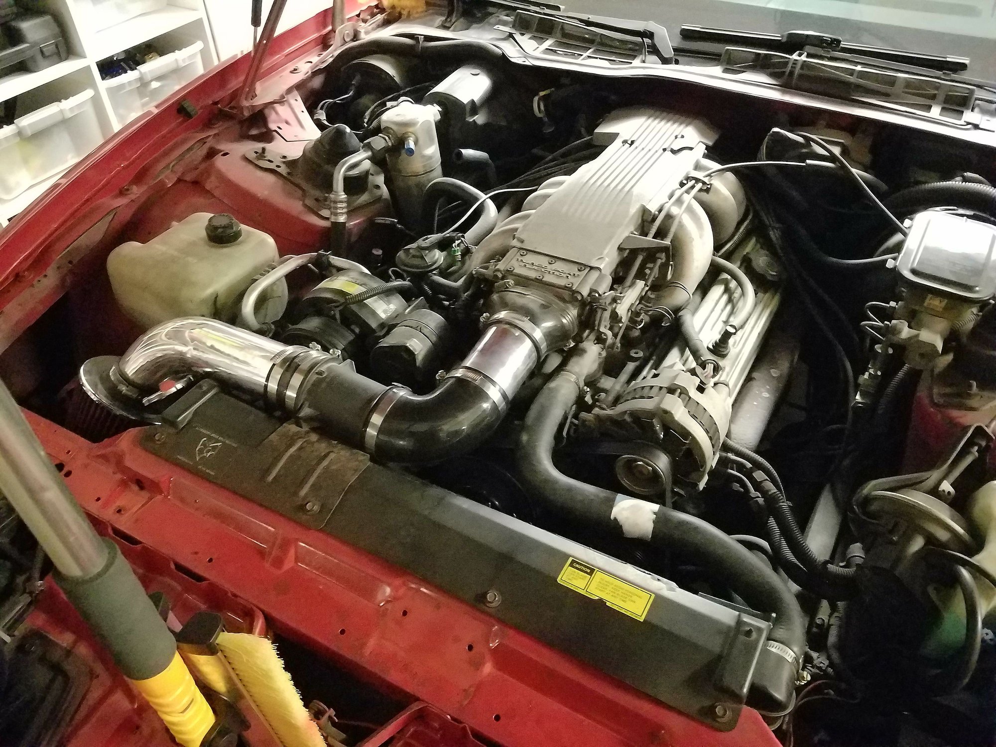

For what its worth, I bought that one on ebay that thtanner recommended.
It fits with no problems, the MAF is supposed to have a little bracket thing that attaches to the upper radiator support/cover.
I can send a pic if you need to see the stock layout

Here you go, if you need another pic at another angle or something, let me know. (Yes I got the red intake & yes it sounds good when flooring it haha).
But you can see the metal bracket that uses two bolts on the pass. side of the upper radiator support/shroud.

Sharp set up. That's the intake from eBay? If so ordering it tonight. Also, that bracket is long gone but I shouldn't NEED it to mount maf right? Not at home to check but I don't believe my mass pigtail would reach that far
Yep that's the one from Ebay, they have lots of different colors and different piping styles. Check the seller "cmpautoparts11"
This is the one I bought: http://www.ebay.com/itm/BLACK-RED-19...EAAOSwcF9UXxL-
Not bad for $55 - I DID have to do just a little cutting on the black rubber parts to make it fit perfect, not hard at all.
