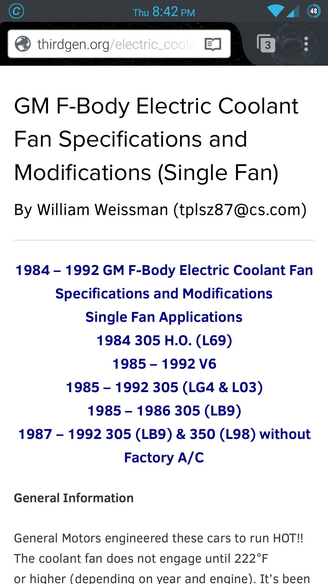

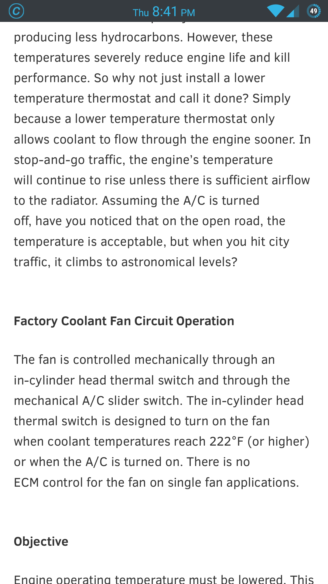

The confusion continues....this is from a tech article on this site
