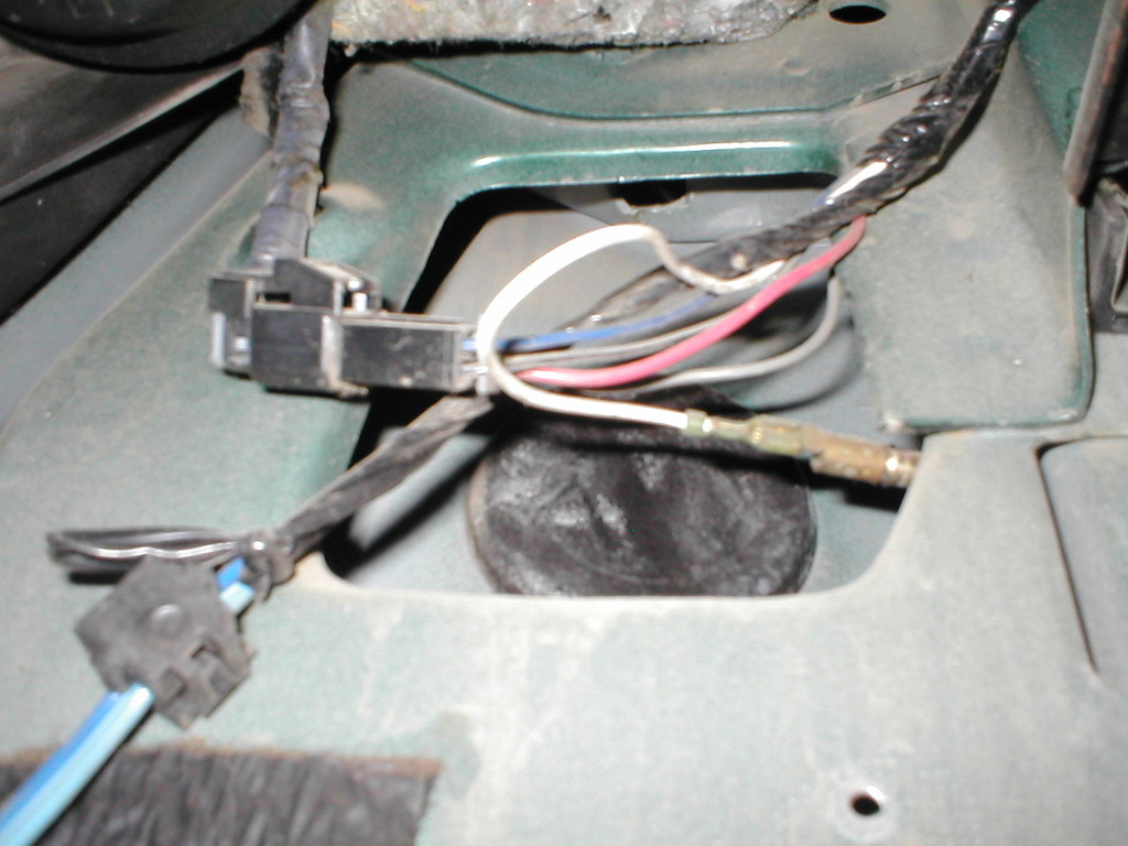

Not the best photos but should give the general idea.
