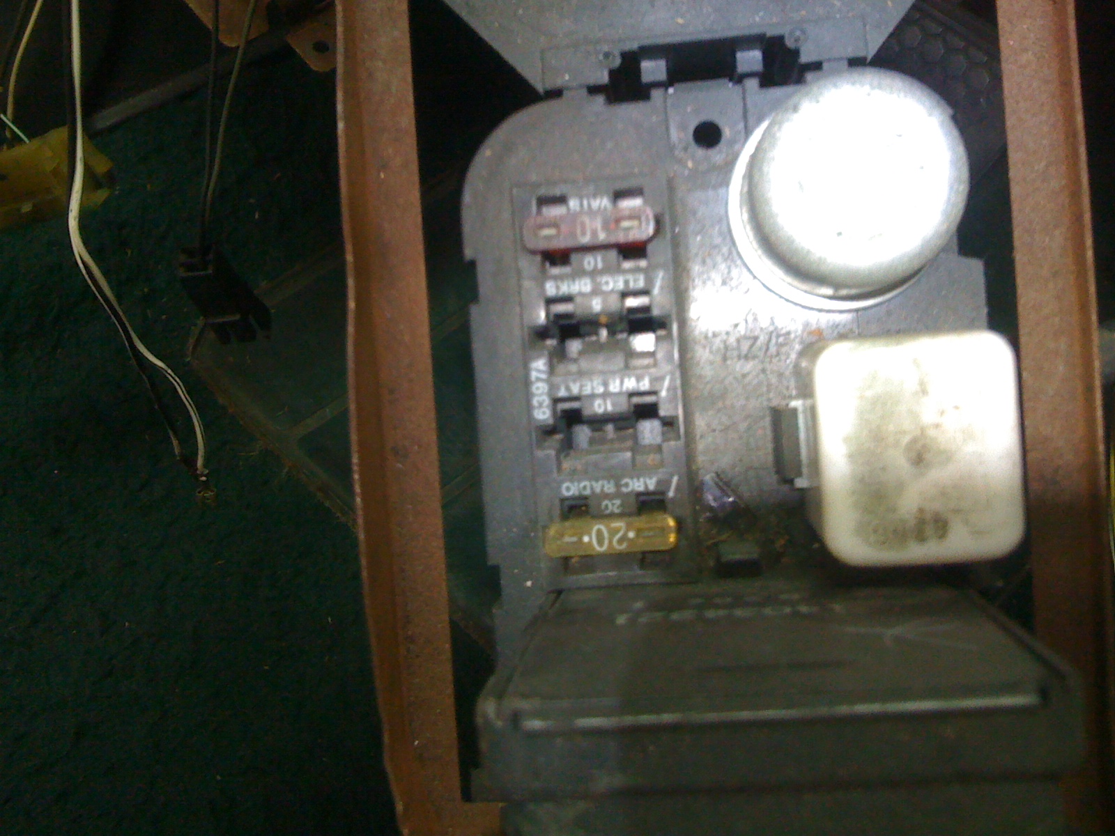

First things first , have you checked the VATS fuse ?
If no , and if you don't know where it is , it's not in the regular fusebox , it's in a little sub panel called the convenience center located in the dashboard right above your right knee , you gotta take the lower plastic panels off to get to it .
A picture of what your looking for ....

Hi OrangeBird, I should have mentioned I'v got a workshop manual (GM) for a 1990 (only year out!) and it says in there to check the vats fuse and ecu fuse and the gauges fuse which I'v done and their all good, however, they were all on the main fuse block, is there a second vats fuse in the convenience centre? or just different on y year to your pic?

Only two fuses on my convenience centre, thanks anyway OrangeBird, I don't want to leave any stone unturned before I have to pay for things.
