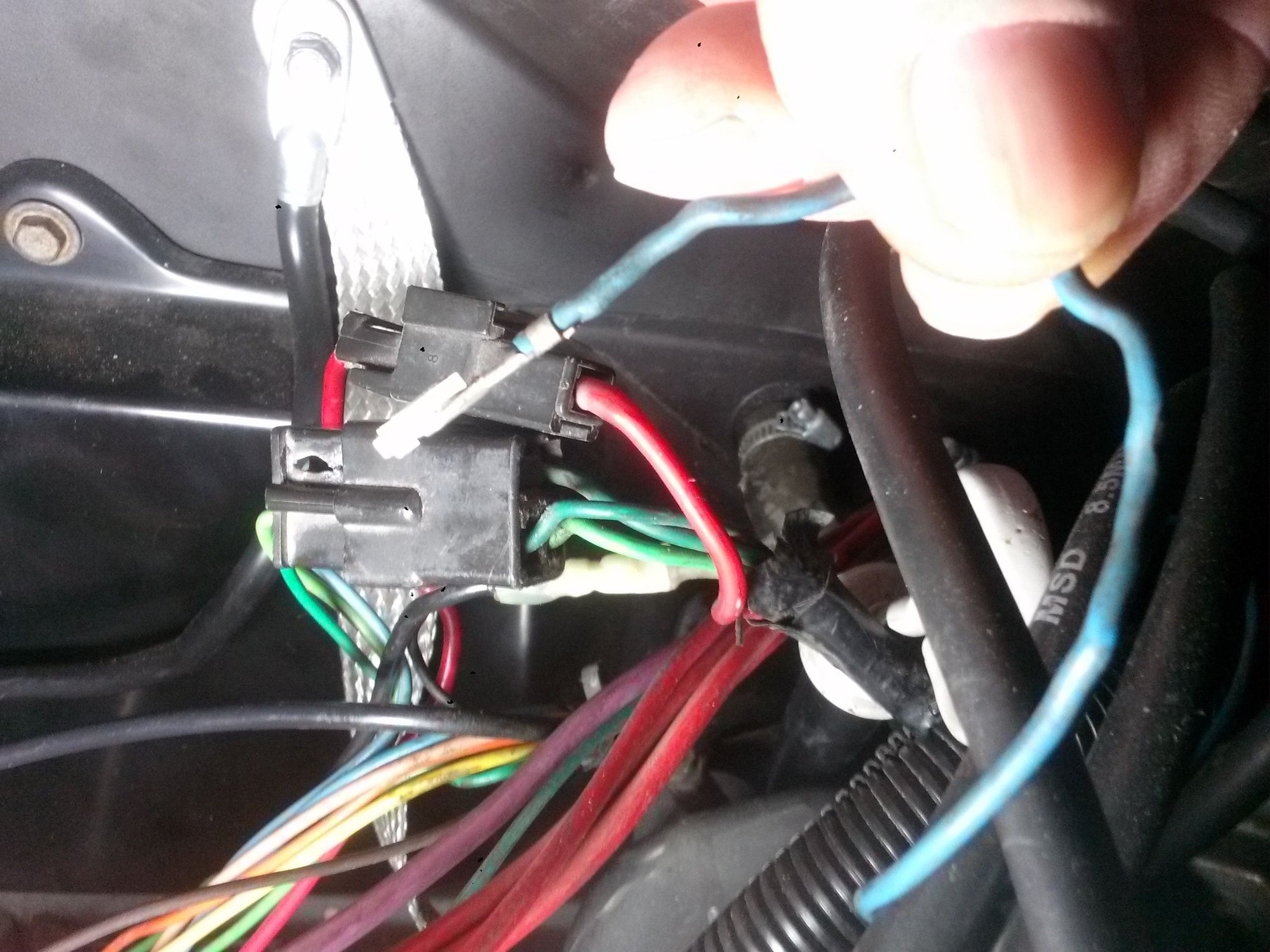

i am cleaning up a mess of old wiring in my '86s engine bay and have a few wires with no home.
First, the single orange wire off the starter lug (the other two attach to the same ring connector) has been cut and just left hanging. what does it run to?
Second, there is a connector with 2 green and 2 light blue wires running into it, mine melted from header heat and I have no idea where the light blue wire runs to on the engine compartment side of the plug.
This is an A/C car that I deleted the A/C on.

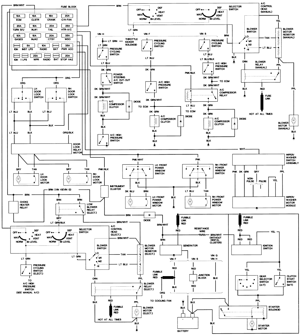

According to this, it looks like the dark green and light blue wires are A/C related.<br/>My car is vin H and I'm not seeing a third red (possibly orange) wire coming off the starter solenoid
