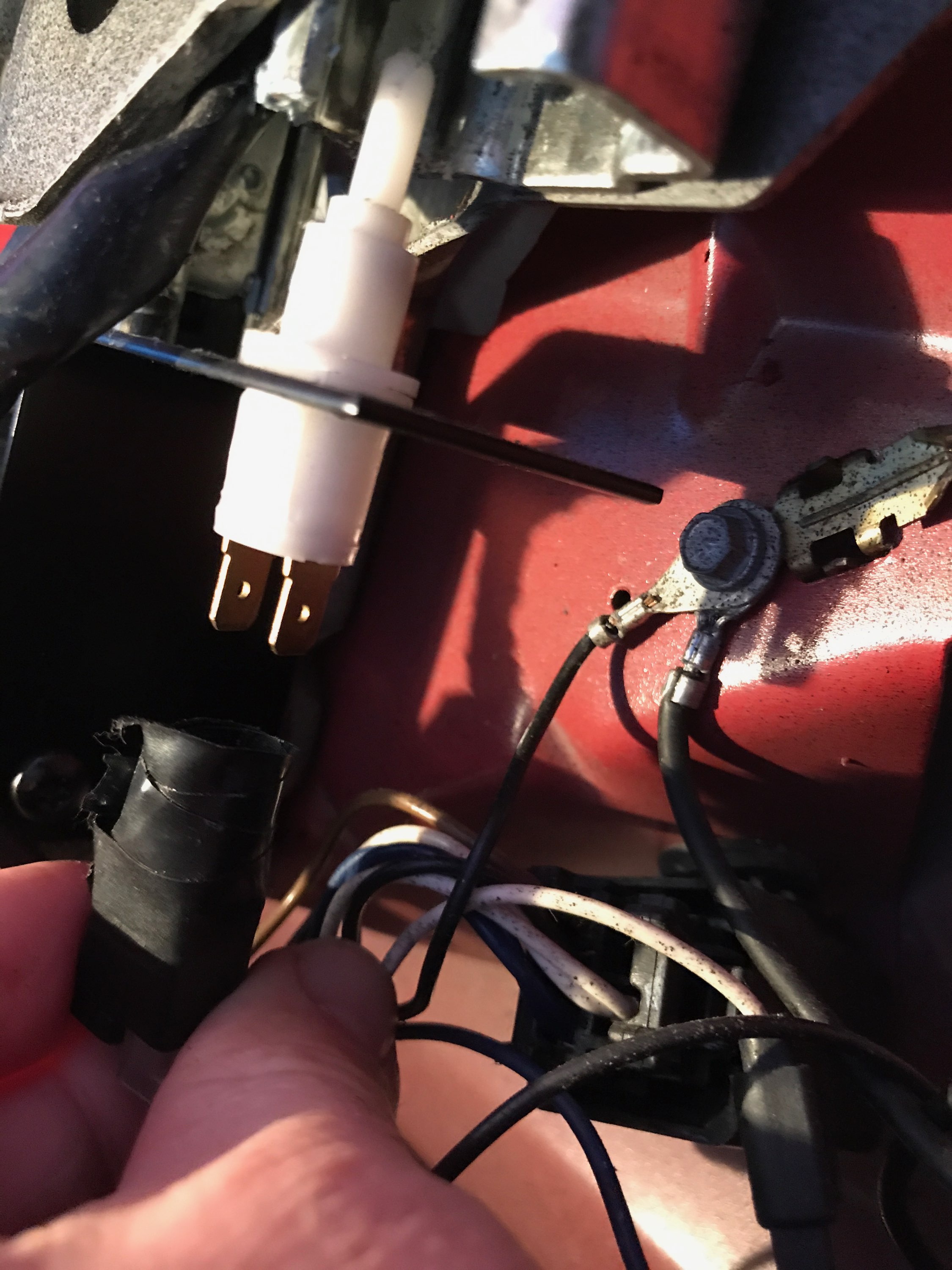

solved! The problem was actually with the trunk release.
Because ASC took T-top coupes and converted them into convertibles, the factory ran a wire to the hatch for the power release. ASC rewired that, and installed a sensor switch at the now trunk pull down and then ran a wire to the 2 solenoids for the Tonneau. This way if your trunk is open, you cannot open the tonneau. The wire runs on the Drivers side, connects at the first solenoid, and then crosses under the front of the back seat bottom, up to the center console and then to the front of the seat bottom, then to the RH solenoid. The solenoid grounds out on the body.
If you have a break in the line the "Dash brake Light" illuminates because the open circuit grounds thru the light to ground...
The special plug ASC installed simply came unplugged, and I just had to plug it back in. and I Zip-tied it so it will not happen again.

This is the plug that came unplugged... 10 min fix, once you know where to look.
