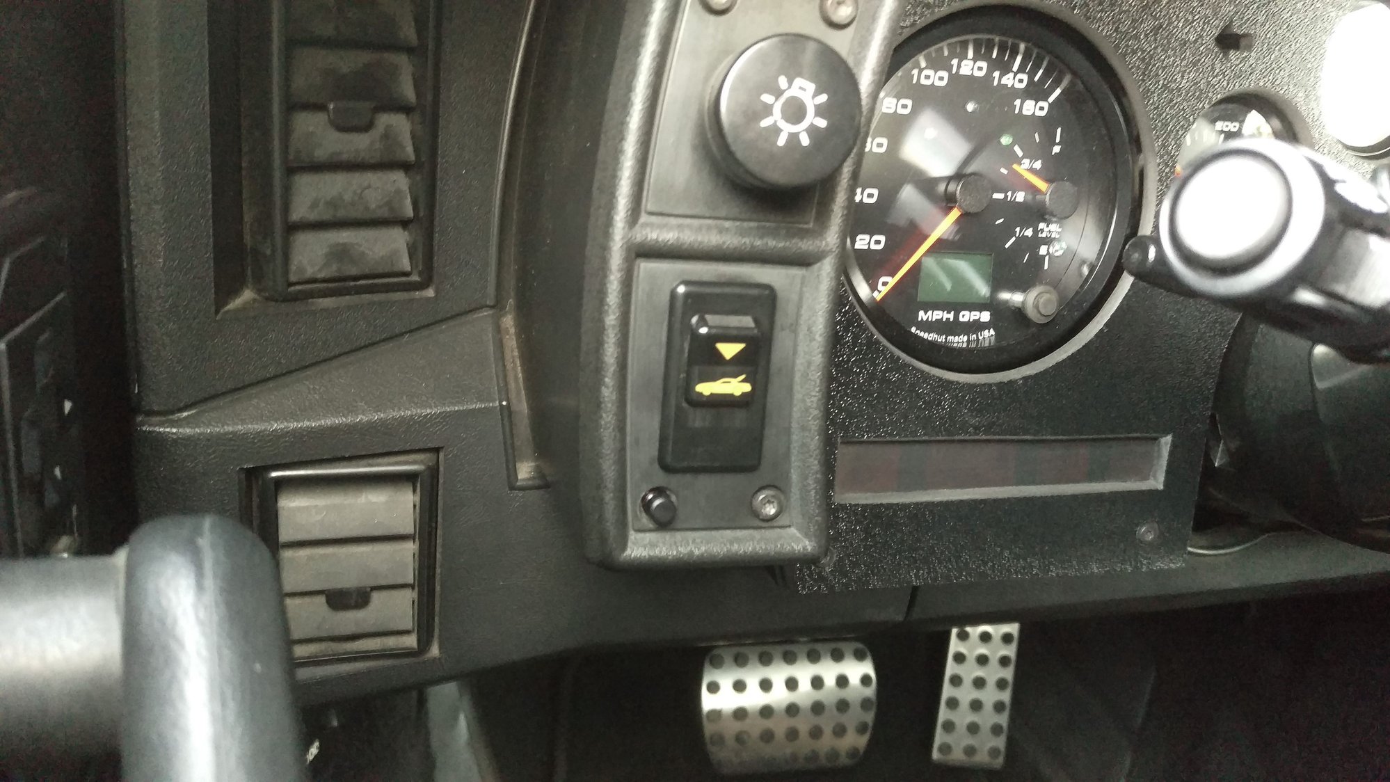

Old post, but.This one from a C4 vette, w/ pigtail Vs connectors.Wired thru the NSS for the trunk release.
Regarding the post above.Anyone ever try this, relocating the solenoid? From the GM service manual.
