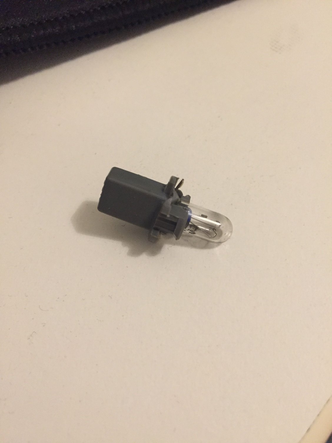

​​​​​​What kind of socket is this?
This kinda looks like a GE882 "Printed Circuit Socket". You probably removed this bulb from behind the pressure gages, right? In that case it is the hidden generator lamp which is not used as a back light but only for the alternator as a starting resistor.
If you got it from behind the indicator lights then it's just a printed socket base for the respective 168/194 or 74 bulb
