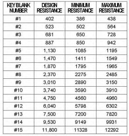

My dad and I used a variable resistor to "find" the correct resistance when my keys were stolen at a bar one night. I believe we had to wait some time between trying each design resistance value until we found the right one. After you find the right one, you just have to solder in the correct resistor, so the vats module will always see the correct resistance, and allow the car to start. As others have mentioned already, the car will unprotected now against theft, so if you value your car, I'd highly recommend wiring in a hidden kill switch (or two) to preserve some sort of theft protection on the car.
This is the table we used to find the correct resistance on my 1988 GTA. I believe these resistance values are the same on Camaro/Firebirds, but if I'm wrong on that, someone will chime in I'm sure.
