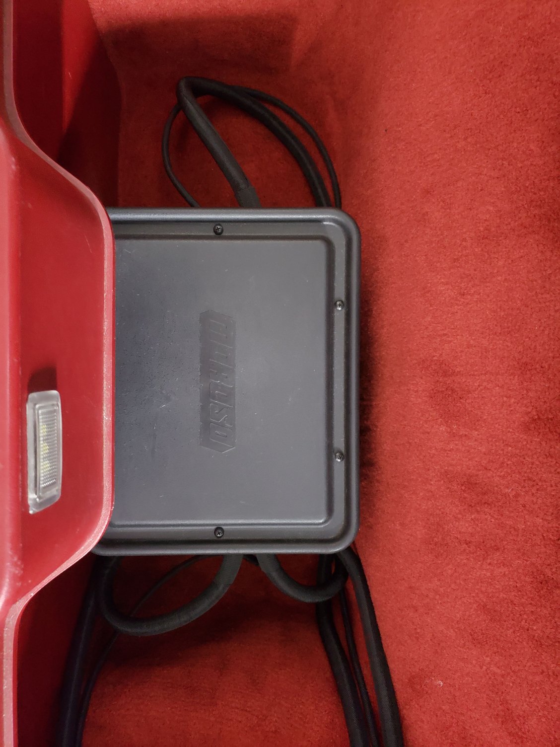

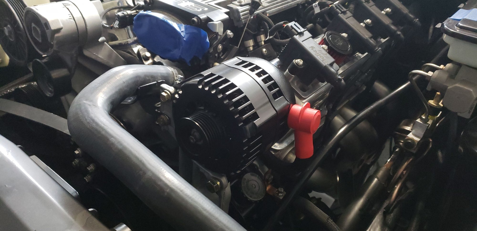

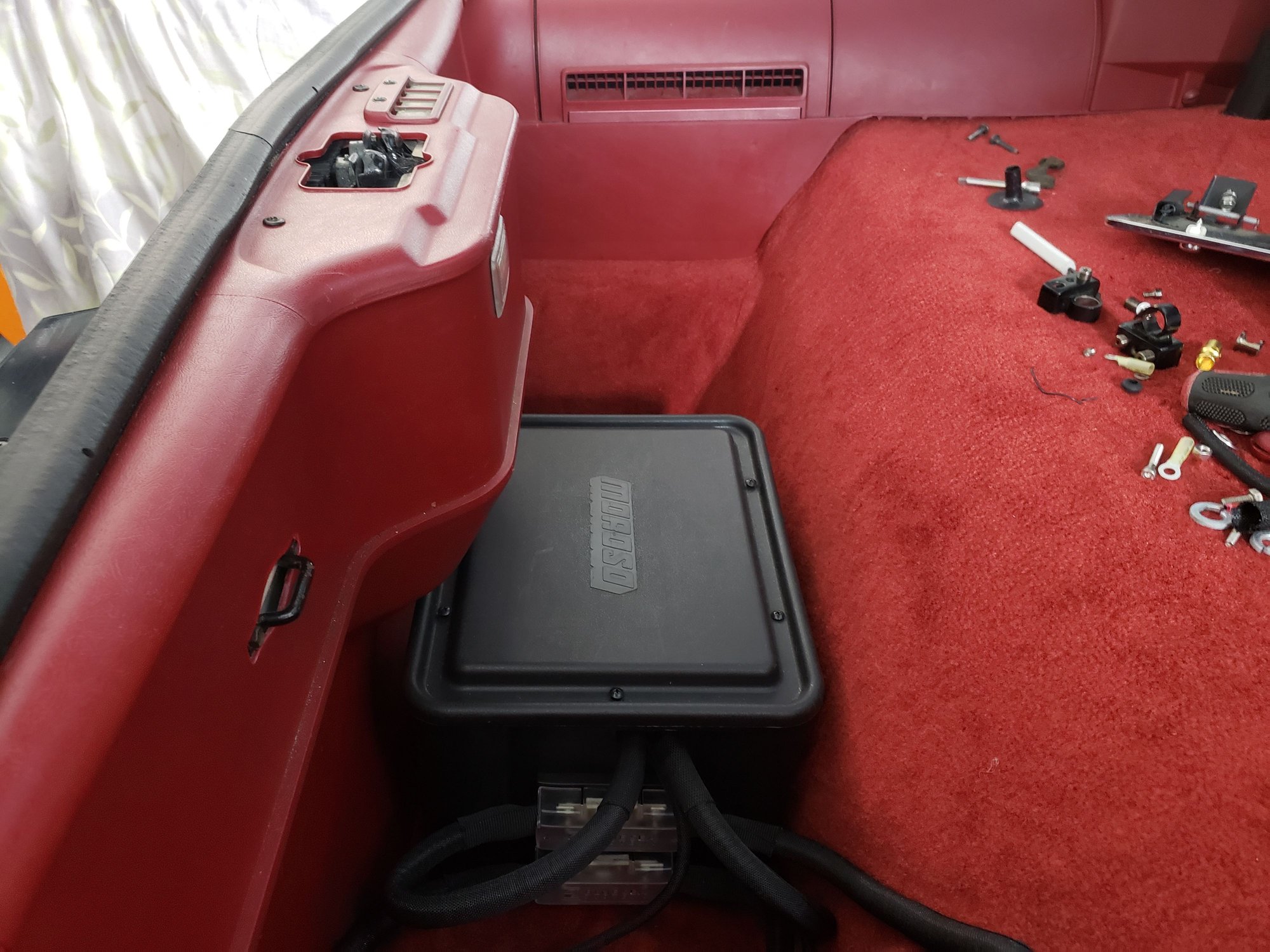

So I upgraded the Alt to a 1 wire. Its took a few wires out of the system and simplified install. The plug on the factory alt fed back into the system and my thought was even if power was killed at the rear shut off it still could power pump, engine etc. So its eliminated. I upgraded the shutoff which was an original cole Hershey, I think that are all anyway to the bigger Moroso unit. Redid the wiring to it through the sheet metal. I also upgraded all the wiring to 1/0 and got all my stuff from CE auto electrical supply. Fused the feed to the distribution block with 250amp anl fuse and fused the line from the alt back to the battery with a 250 anl fuse as well.
If anyone is curious the wires are covered in Techflex woven F6 with woven heat shrink. So basically feed to the main power distribution
Everything takes power off this. The c100 main power wire gets power off the starter lug which is fed by the distribution block. That in turn feeds the whole car fuse panel. Things taken out of the fuse panel draw are the ecu, injectors, fuel pump and blower motor and ac. So these dont draw out of the fuse panel anymore.Fuel pump, ignition, blower fan and all 12 volt key on sources are off this block. They are fused and relayed all weather packed So if switch is turned off nothing gets power but the 12 volts to the dominator, which is hard wired in with a 8 gauge wire, feed and ground. Alt wire will still be hot but car cannot draw power as nothing is teed off this connection. Alt wire and battery wire is fully covered throughout the car with the F6 woven for abrasion resistance. Inside the engine bay the starter is covered with DEI silicone fire sleeve. The alt wire from the firewall to the alt has 2 coverings. The F6 woven then Hotrod sleeving then capped with a red lug protector. I think I covered all bases in terms of power and grounds. Totally overkill on everything and NHRA legal.
