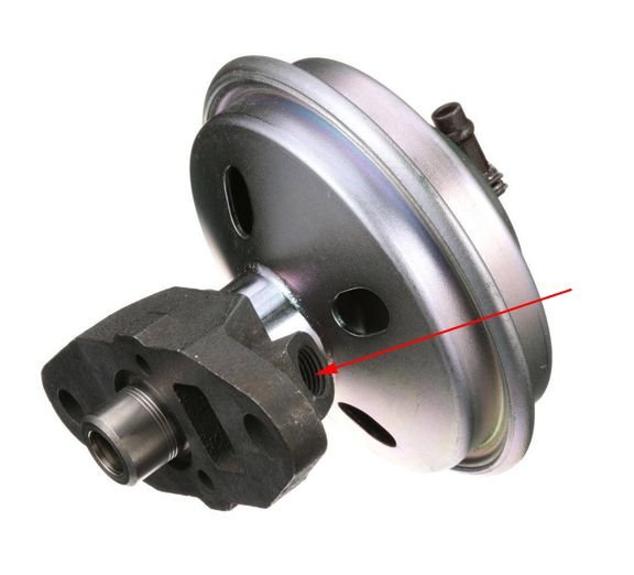

This might be a dumb question, So there's a place on the egr under the plenum to connect to.
Old Jun 20, 2023 | 05:42 PM
paulo57509's Avatar
Posts: 3,178
Likes: 48
From: Tracy, CA
Car: '87 IROC
Engine: LB9
Transmission: TH700R4
Re: What does this wire go to?
The temperature diagnostic switch is essentially a temperature sensor. The sensor wire is routed along the passenger side fuel rail (IIRC). It looks like this:
The sensor screws into the base of the EGR valve. It tells the ECU when the EGR is opened by sensing the rise in temperature.
