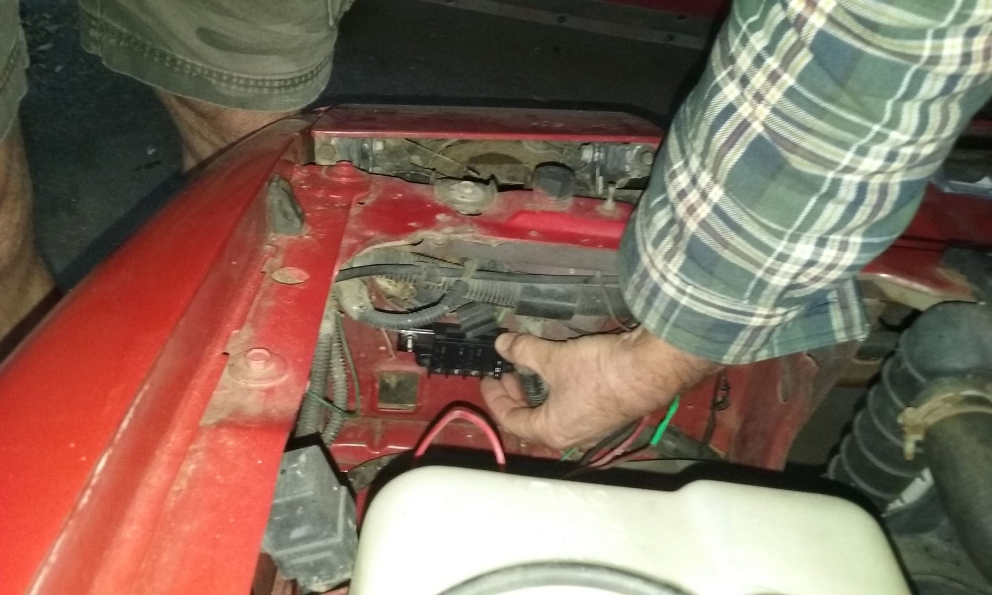

Adding a power distribution block to clean up my battery terminal and make my wiring more organized and easier to follow. But I can't decide if I should mount the block to my driver side in front of the wheel well or the firewall near the brake booster? I plan to run the feed for it up front in the channel forward of my radiator.
The block will have my amp, fuel pump power feed (to a relay), and later plan on installing electric fans.
My concerns of course are accidental grounding when working on car, water, and ease of access.
This is the style distribution block I plan to use.
What have you guys done that works well?

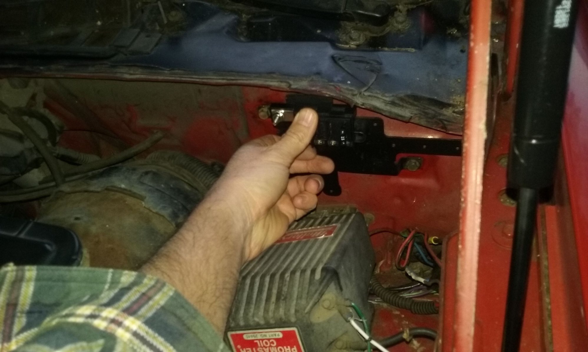

I picked up a small fuse box to use as my distribution block instead. Which of these two places would be better to mount it?
I'll be running a twisted pair of 8 gauge wire from the battery to it. Coming off it I'll have my amp and fuel pump power and down the road dual electric fans.

Closer to the battery tends to be better. However, as long as the supply wire to the fuse block is properly fused, any location would do. To simply the wiring, keeping the block close to the relays or other equipment it supplies isn't a bad idea. Keeps things tidy too.

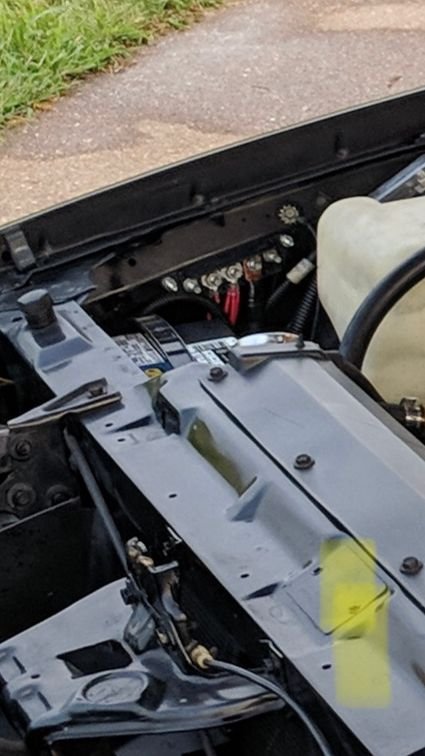

Old Feb 22, 2020 | 10:32 PM

Originally Posted by GASPEDDLER
Are you running your accessory wires along the passenger side and across the firewall?
Old Feb 22, 2020 | 10:43 PM
GASPEDDLER's Avatar
Joined: Mar 2014
Posts: 728
Likes: 51
From: South Texas
Re: Where to mount power distribution block
Yes
