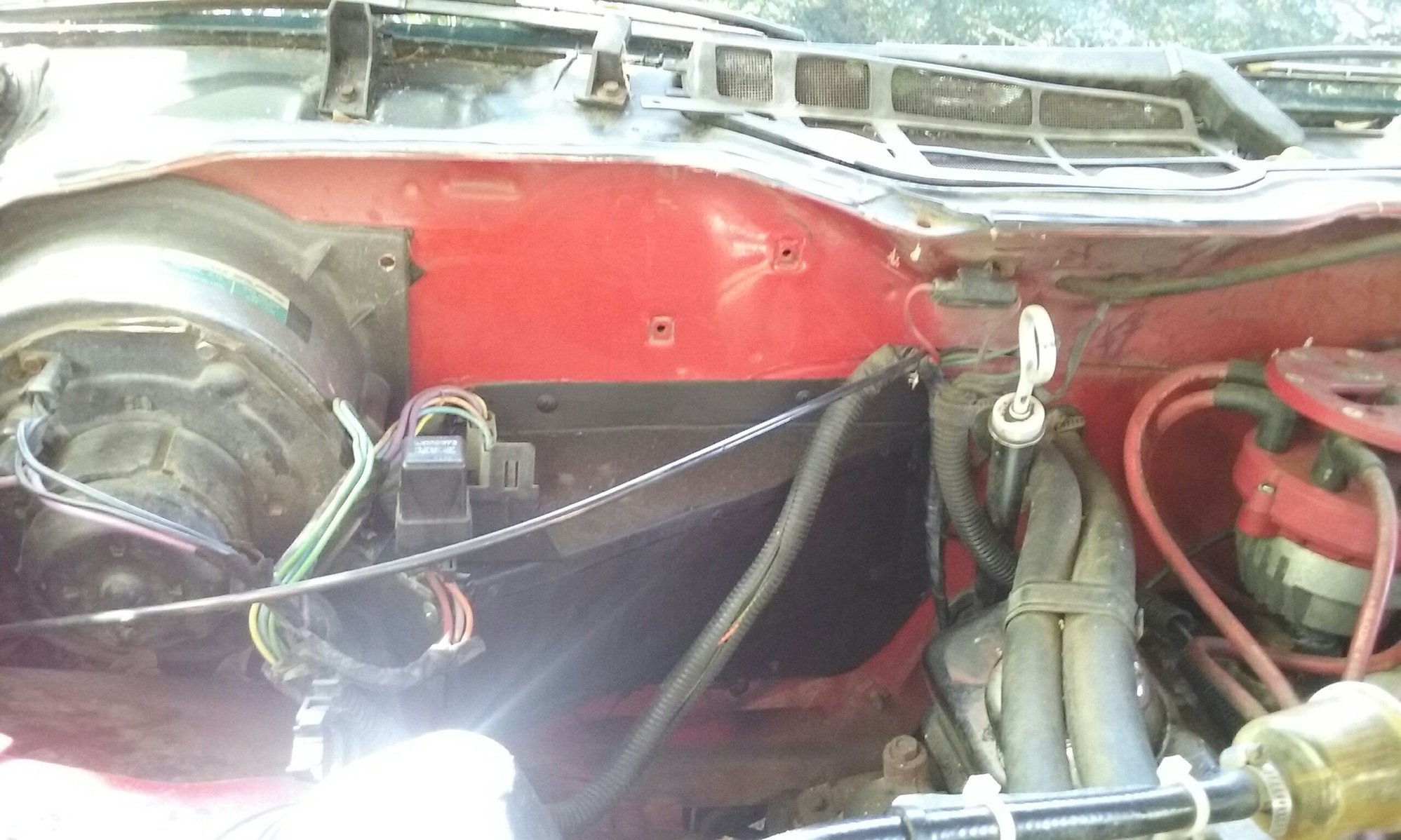

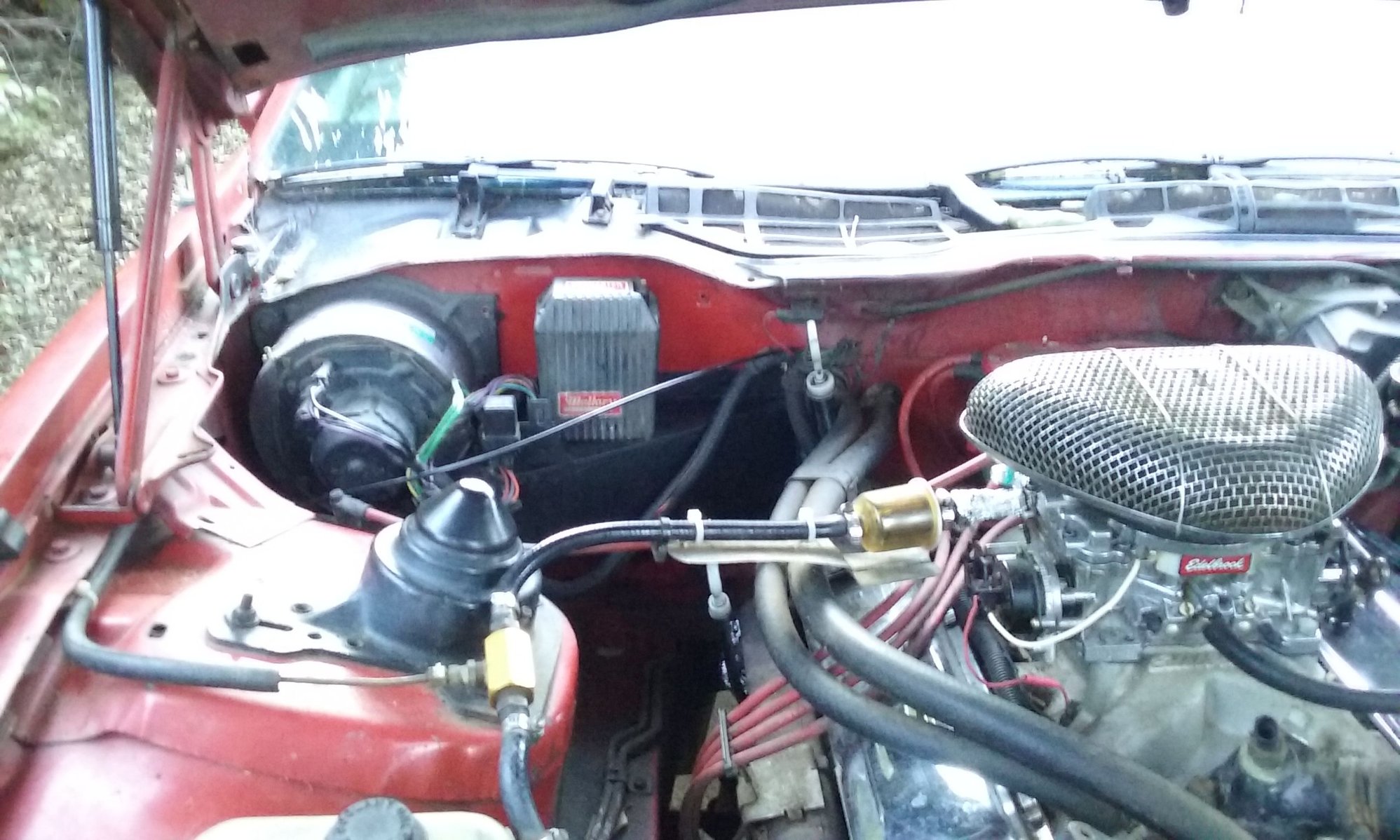

I'm rewiring my car and want to move my coil(and resistor) to my firewall but would have to mount it horizontal. I'm hearing mixed opinions on the subject. Anyone have any knowledge or experience doing this with a mallory promaster coil (#29440 circa 1992)?
Current location:
Location I want to remount it to:

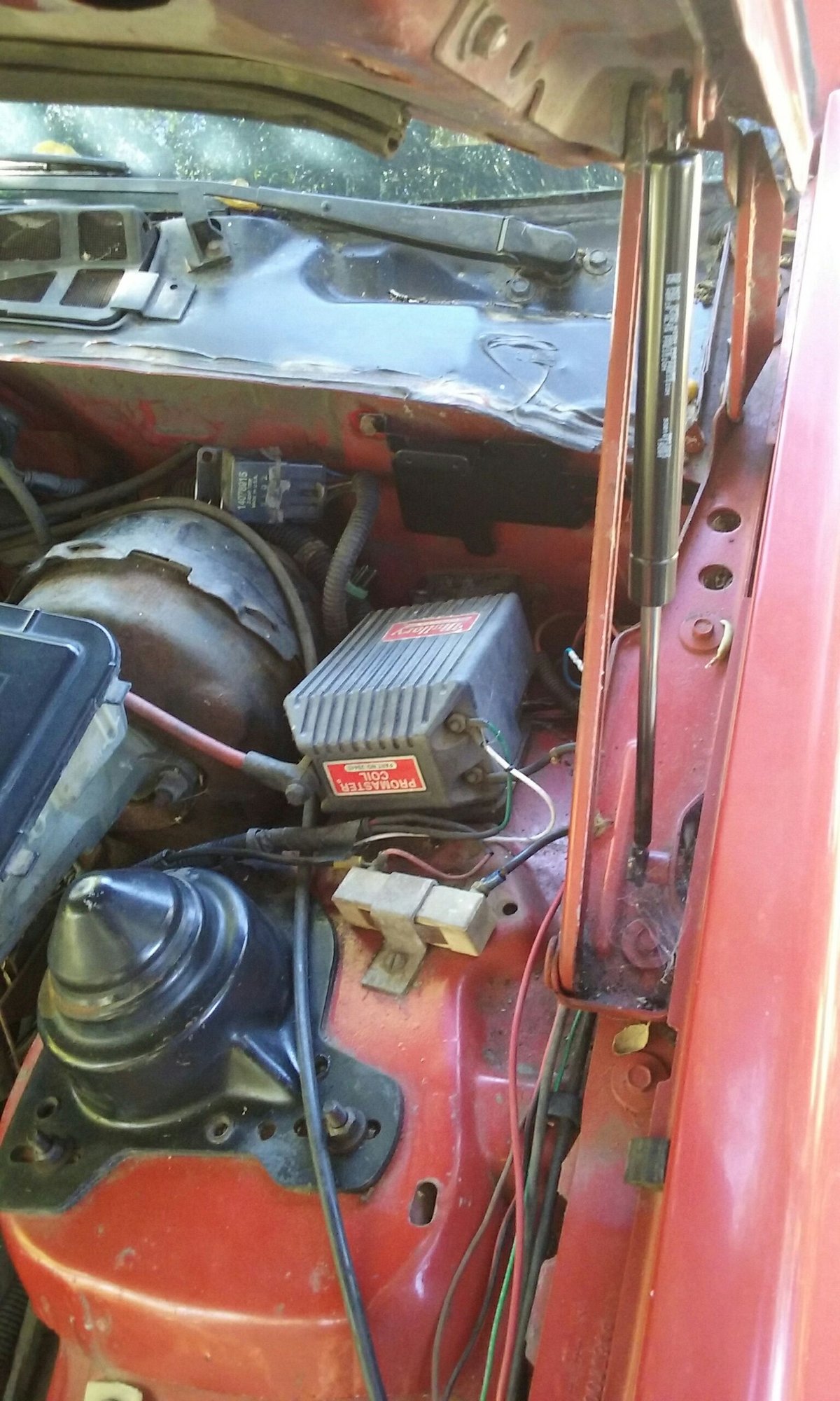

Of these two positions, which one would be better?
I'm a bit concerned about how close the high-voltage terminal is to a ground surface in the upright position and the heat from the exhaust(and the possibility of the oil not covering the internals) if in the horizontal position...
