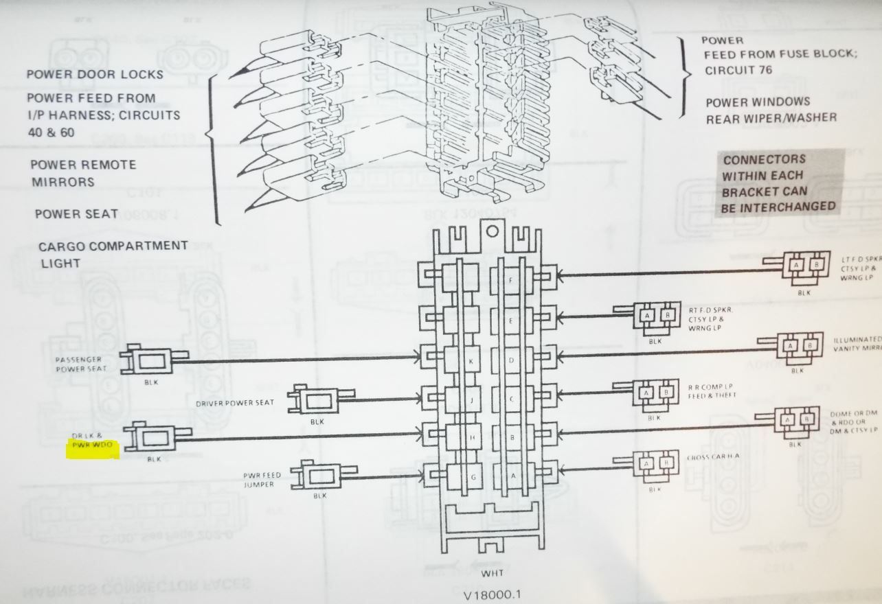

It has 4 ends and the part thats for power has a pink and white wire and a solid pink wire the temp control panel has a similar connection

Re: Power windows
1987
1991
If your car doesn't have any power options, you might not have the distribution block, or the power jumper wire that runs from the back of the fuse block to the distribution block to power everything on the list.

This is the harness I bought and the owners manual for the car said power windows were a option

Re: Power windows
Yep, pwr windows were an option, but if you don't have any of the options in that first diagram, you might not have the distribution block. Look under the dash on the driver's side. Go up and towards the front a bit from the hood release.

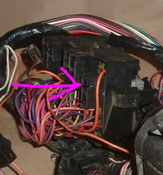

So I ended up having the right hook up it was that first box but the pic shows 3 on the right side plugged into there do I need a connector from the fuse box along with the harness for the windows? Because right now it only has 2 plugs with orange wires in it

Re: Power windows
Where it says Pwr Wdo jumper... It's jsut a short pink wire that goes into one of the sockets on the block, then it snaps into the pwr acc socket on the back of the fuse block. I've got one around here somewhere, but I've got a LOT of thirdgen parts around here. I'm not even sure where to start looking.
You could always touch the terminal strip with a test light, and turn the key to run and see if the test light comes on.
