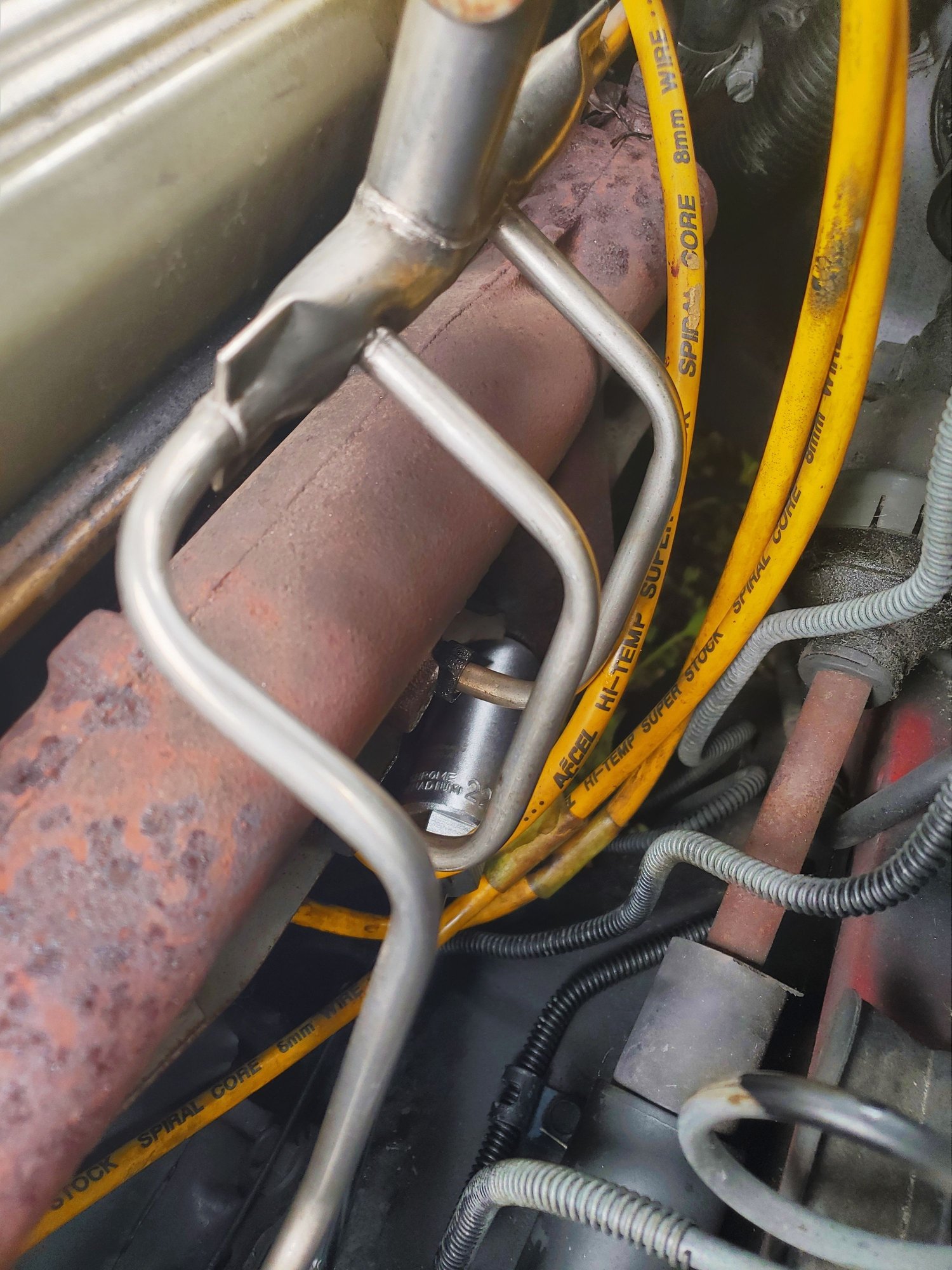

Just for anyone who might want to look this up in the future for any reason.
This is the location of the O2 Sensor on an 88 305 TPI Camaro
Right where that special 22mm O2 Socket is, I would suggest getting the right tool, and you will need some extensions, as well as some PB Blaster if it was anything like mine.
