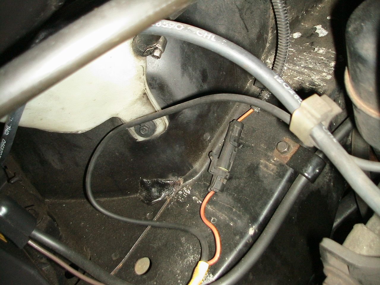

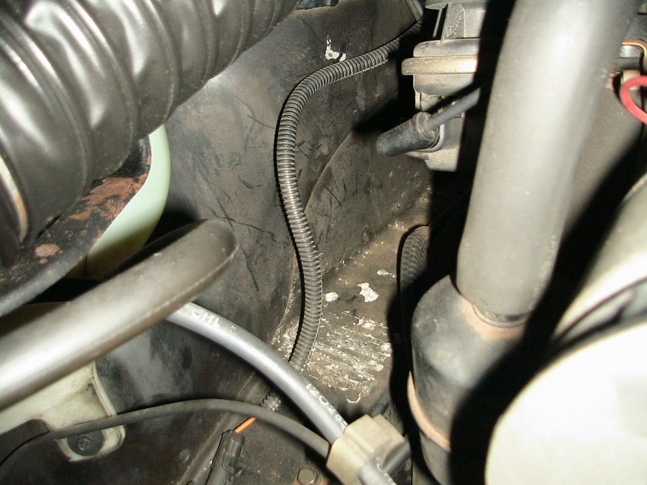

Pigtail On Positive Battery Cable...
What is the pigtail for? The alternator output wire?...

What application is it on? Year, camaro, firebird, tbi or tpi. Pictures if you could. It possibly is a aftermarket battery cable

Where did the factory connect the alternator output wire to on a '83/'84 thirdgen? Was it connected directly to the Positive battery terminal? Was it connected to the pigtail wire on the Positive battery cable? Was it connected to the Positive terminal on the starter?
Someone here must know...

My 1984 Has Two Wires Going To The Pigtail On The Pos Cable,The Thicker Wire Goes To The Alternator The Other Feeds To A Main Harness.
