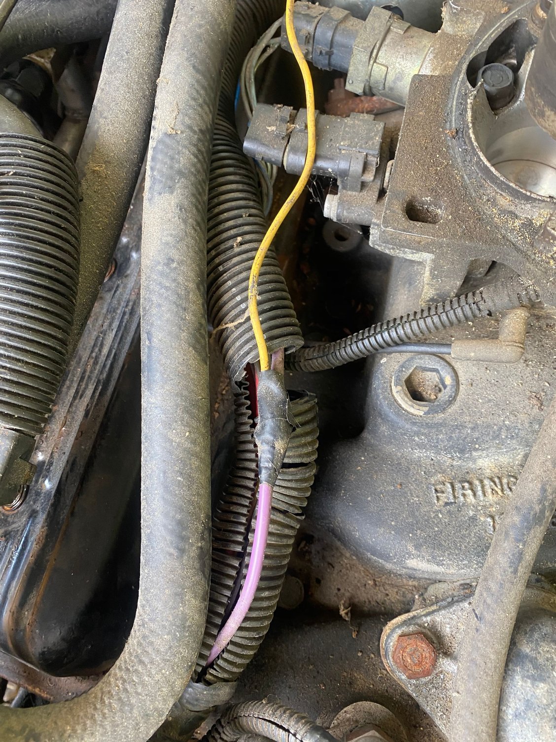

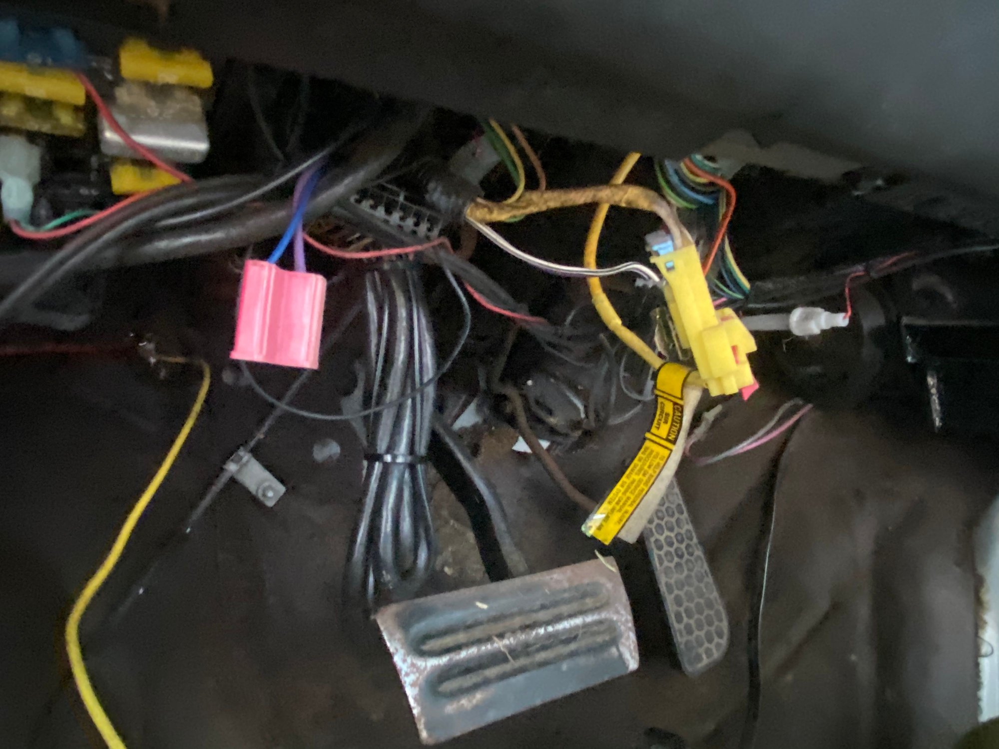

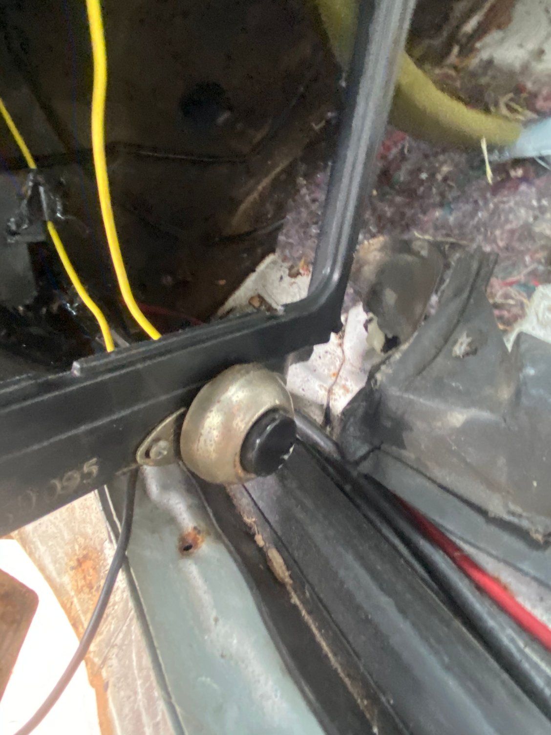

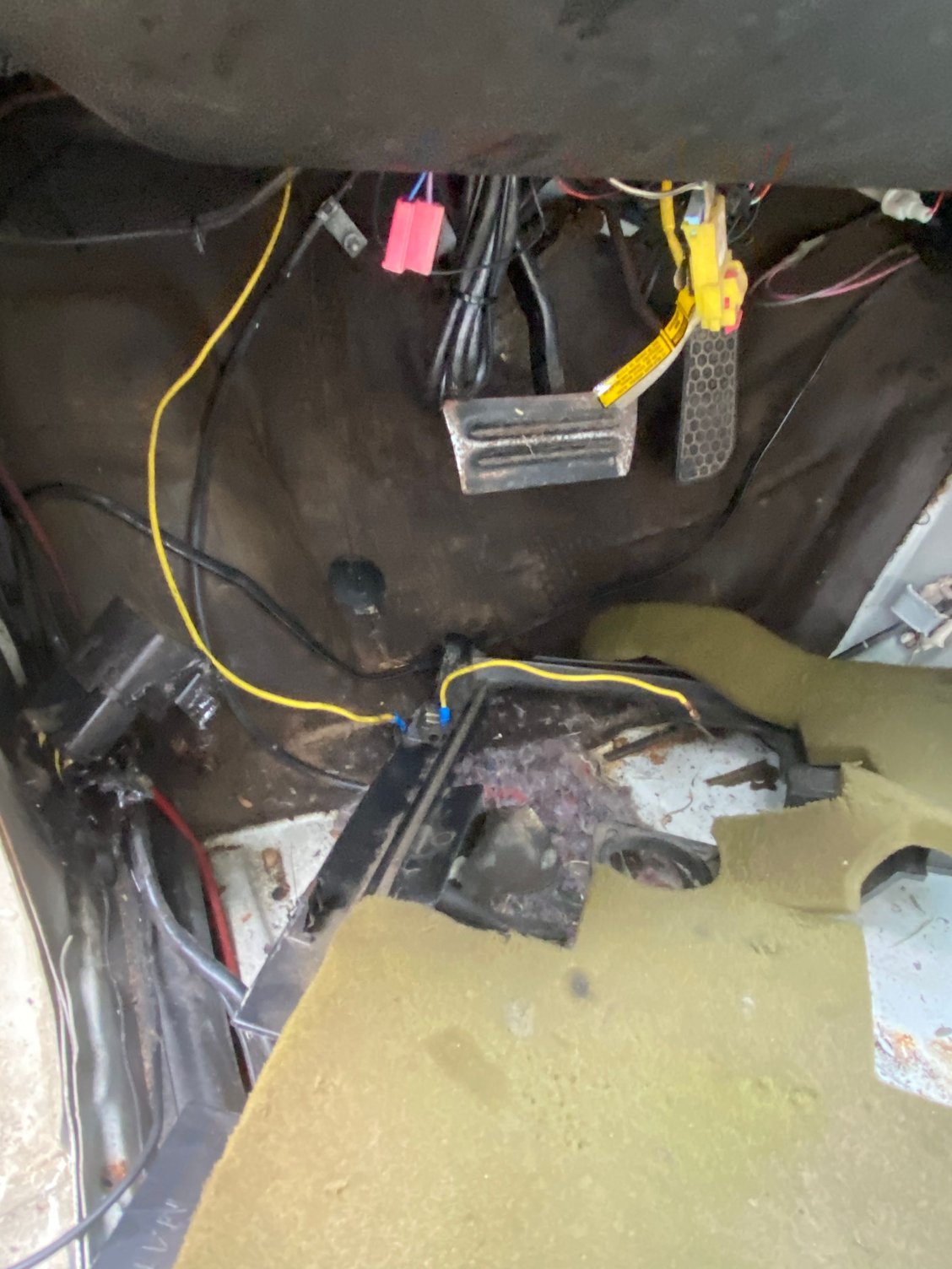

In my 1990 Bandit II Edition Firebird I have this wire that runs from a button under the dash into this purple wire in the wiring harness in the engine bay. The other side of the wire on the button isn’t connected currently and I have no idea what it’s for. What is the big purple wire for? And what might the button be for?

That fat purple is the starter solenoid. So the button is probably an alternative to the key for starting.

Could it be possible that it’s a kill switch then? Where do you think the other end would go into?

No. It is a start switch.
The other wire no doubt went to battery somehow. Doesn't matter though; it is the trash. Get rid of it so it doesn't cause you any trouble.
