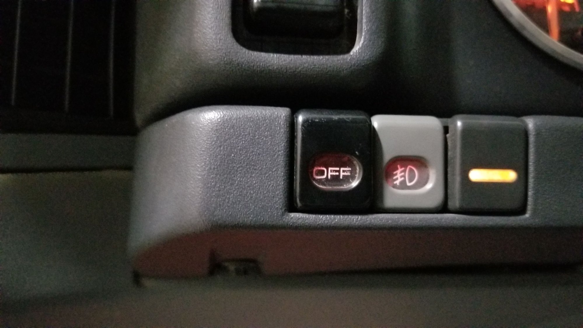

The brown wire carries power to energize the switch, itself. I connected it to a blank IGN terminal in the fuse box, so it receives power ONLY when the ignition is on, preventing the risk of accidentally leaving the DRLs on after turning off the ignition. That also means I can leave the switch ON all the time, and the DRLs will be powered on and off, "automatically," with ignition power. And I'll still have manual control when the ignition is on.
The brown/white wire carries power to illuminate the DRLs. Its terminal is energized by the power that comes into the switch through the brown wire terminal when the switch is ON.
The purple wire carries power to illuminate the switch's ON light. It's looped from its terminal to the terminal for the brown/white wire. So both terminals are energized together when the switch is ON. Therefore the switch's ON light will be illuminated only while the DRLs are illuminated.

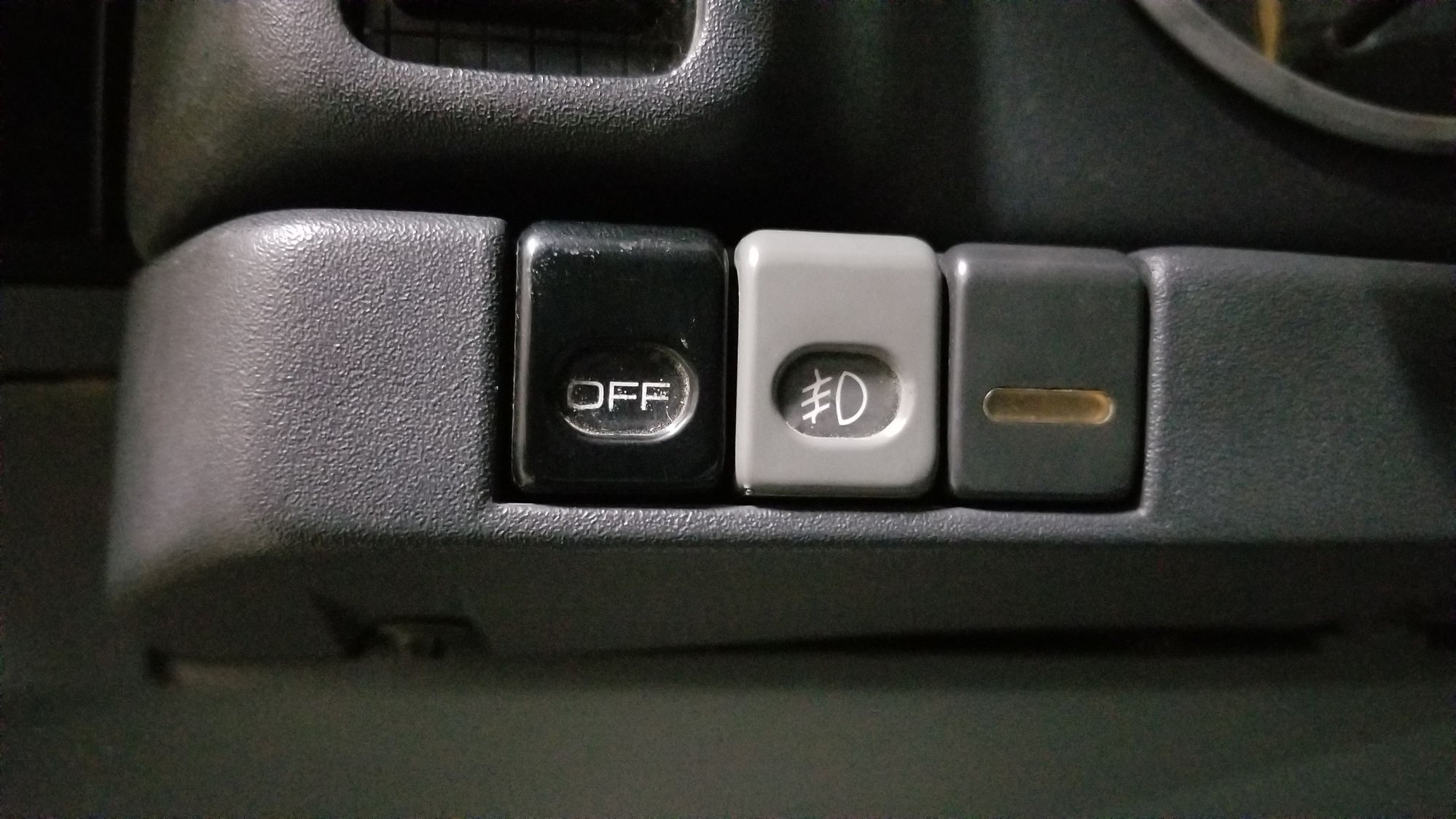

If you already have factory foglights, but would like additional lighting, then this might work for you, too. 85-89 Firebirds have additional locations in the dash that are the same size and fit as the one for the foglight switch, so they can host factory foglight switches in lieu of the switches for which they were so designated.

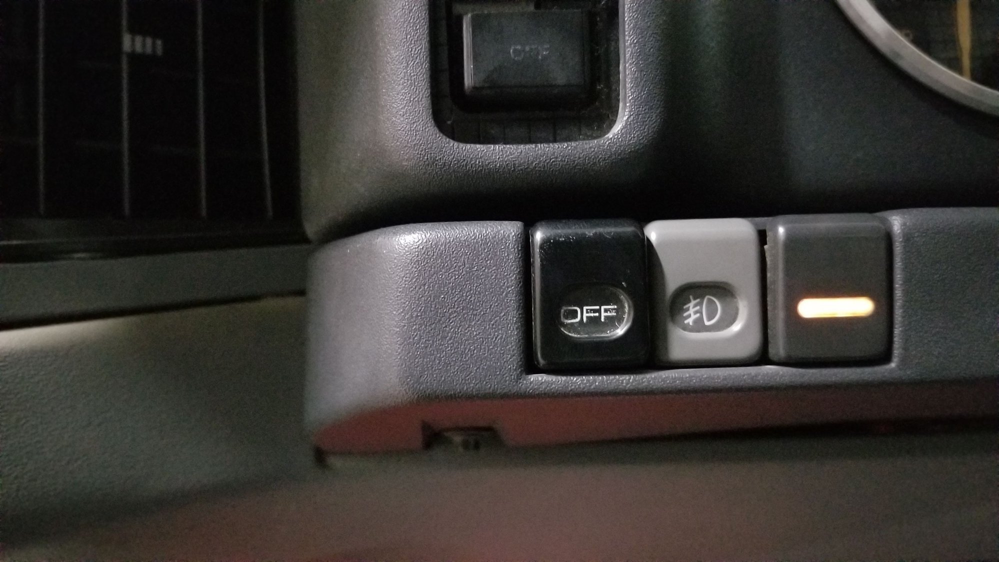

In Formulas and many base Firebirds, there's a blank plug in the space for the actual foglight switch, left of the steering wheel, which is where I installed my switch.
In 85-88 Firebirds, there's a space designated for the GAIN switch, which powers the subwoofers in cars that received the Performance Sound System option. But if the car doesn't have that option, and most Firebirds didn't receive it, then there would be a blank plug in that space.
And in 85-89 Firebirds, there's a space designated for the Window Defogger Switch, which would be filled by a blank plug if the car doesn't have that option.
A factory foglight switch will fit into all of those locations. It will look a lot better than the blank plug(even if you don't wire anything to it). And it will match the rest of the interior. So plug in a switch, connect your new auxiliary lights and LIGHT UP!
