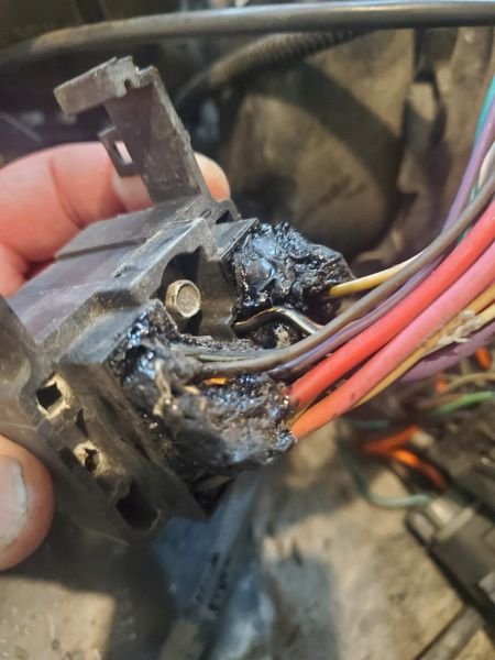

What is this goo?

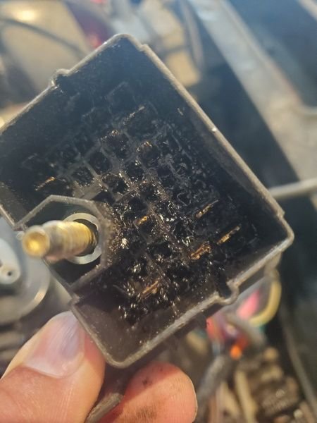

Alright, I'm going to guess that it's some sort of waterproof stuff that protects the connections blah, blah, blah? Whatever it is, it's sticky. What is it and is it good/bad? I did buy a replacement c100 firewall harness connector since I do plan on rerouting some of my wires in the engine bay and I wanted to start from the starting point. Any help on what this messy goo is? The photo is of the same connector showing both sides.

Factory dielectric grease
So I shouldn't worry about it? If I do replace it, should I buy a tub of dielectric grease and put it on like that?

When I make new harnesses I put CRC dielectric grease in them. You can clean the old grease out, but it's probably more of a pain than it's worth. You can just get a new C100 connector for a couple bucks, they aren't expensive
In the Trenton area
This. De-pin it and buy a new one. Use PB blaster on the terminals to clean off the remaining ectoplasm. A new one on ebay is like $9.
