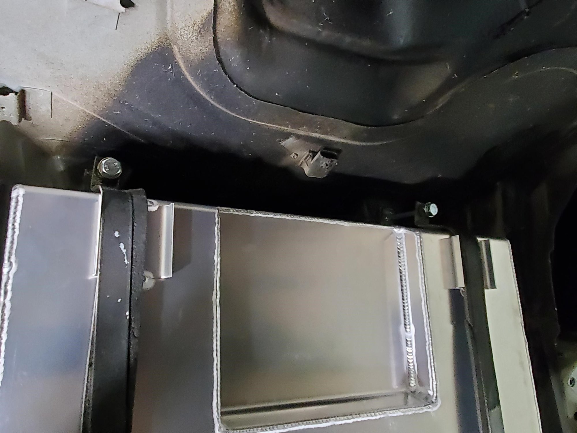

90 to 92 gas tank wire colors .. pump / sending units.. witch ones are what..?

Black - Ground
Grey - Power
Purple - Sending unit

If a new electrical connector is needed, they are still available.
Delphi Weather-Pack 3-way Connector with Lock/ CPA.
Delphi part numbers:
-Body =12020829
-Terminals =15344719
-Seals =15324982
-Lock/ CPA =12020833
-Lock/ CPA with Tether =12092054

What fuel pump will you be running though? Most have to run new power and ground wires to support the power loads.

yes I have to Upgrade the fuel pump Power Edelbrock pump 1794 120gph 12an in and out. but I can still use the fuel tank sending unit wire ..Just 1 pump..I like to have back ups..just in case..
