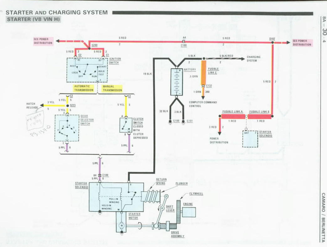

For the Neutral-Safety, the Car would have originally had a Switch that would work off of the Clutch-Pedal.
Here is a Schematic below:
The 10 AWG Purple Wire is connected to the Starter-Motor Solenoid, goes through the C100 Firewall Bulk-Head Connector, and goes under the Dash-Board (on the Driver's side).
The 10 AWG Yellow Wire is connected to the Ignition-Switch and goes under the Dash-Board (on the Driver's side).
Both of the Wires originally would have gone to the Neutral-Safety Switch for the Clutch-Pedal.
These Two Wires will need to connect to the aftermarket Shifter Neutral-Safety Switch.
Extend the Two Wires with 10 AWG or 8 AWG Wire as needed.
