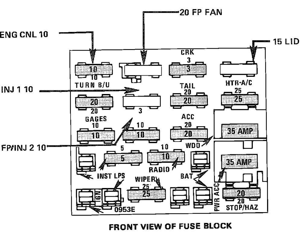

The Interior-Lights and the Relay for the Lift-Gate Latch are both on the 20A Accessories Fuse.
Also the Interior-Lights pass through the C238 (Power-Accessory Junction-Block) Connector... check continuity.
I would look at this Fuse, and then test the Power and Ground Circuits for continuity.

Where is the Power ACC Junction block?
