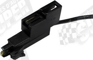

There are also plug in connectors by Pico that are designed to fit into the various types of keyed slots in the fuse block.
955-BP and 958-BP.
Better than a spade terminal which have a tendency to fall out at the most inopportune time.

Amazon uses part numbers listed below
Pico 0951pt Gm Fuse Tap Batt Cavity(Blk)
Pico 0952pt Gm Fuse Tap Ign Cavity(Clear)
I found those in the Pico catalogue.
They were in stock at my local auto parts store.
Doing a quick search and by your description above, I'd say those will also work.
