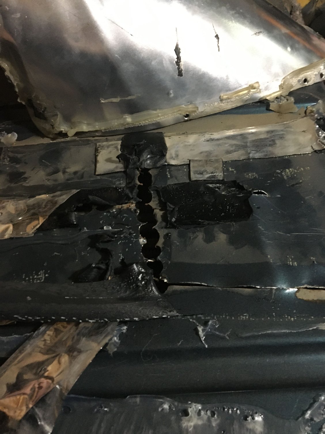

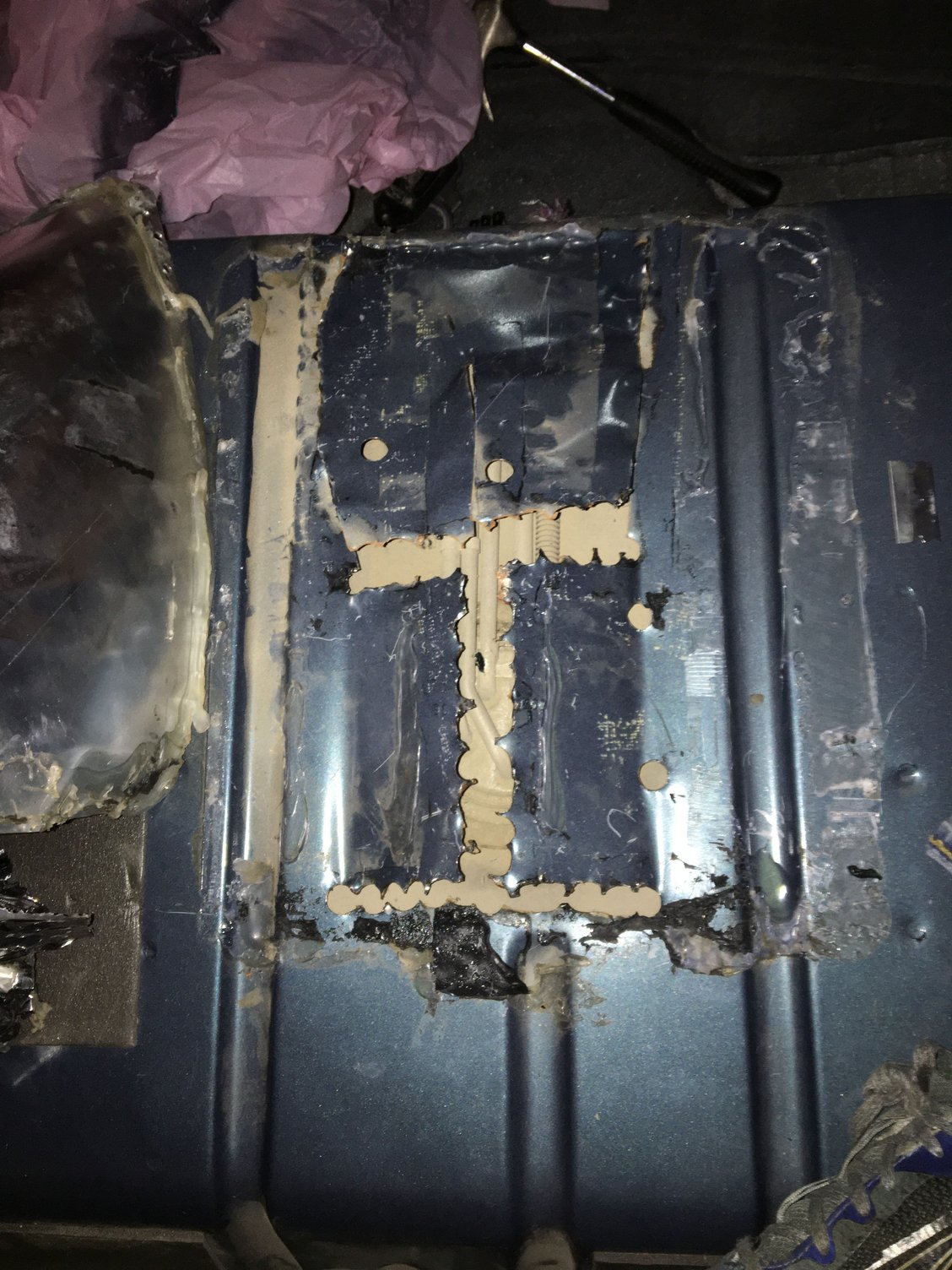

Sending unit is in fact not reading at all. Going to replace the sending unit and fuel pump. Mozzle do em together. My hatch panel was already cut by a kindergarten with a 1/2” drill bit their eyes closed. Gotta clean up someone else’s mess but glad I have access this way. Totally worth it.
