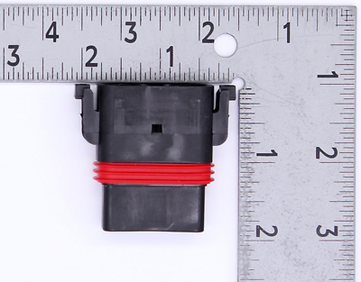

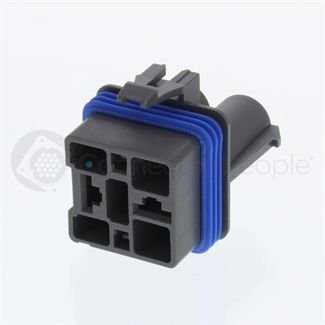

Old Apr 10, 2022 | 06:47 PM
vorteciroc's Avatar
Top Answer: 1
Joined: Jul 2006
Posts: 2,924
Likes: 803
From: 212 is up in this Bit@#
Re: Missing fuel pump fuse
Originally Posted by Michael Beck
GM "hid" that one by the battery, I think there is another one also there. They did strange things back then...........
They were not really Hidden...
Just more of an after thought (something that most Auto Manufacturers do often).
Sometimes these after thoughts end up making nice accessories like this:
Now anytime someone wants to add one SEALED Fused Circuit for an Accessory (Fog Lamps, Electric Fan, Etc)...
With the Parts above (up to 40A) it is easy enough to do.
Not to mention, Parts like these are also produced for a Sealed Relay as well.
I personally offer Parts similar to those above, for SEALED Circuits up to 60A (Maxi-Fuse):
And for Relays up to 60A:
