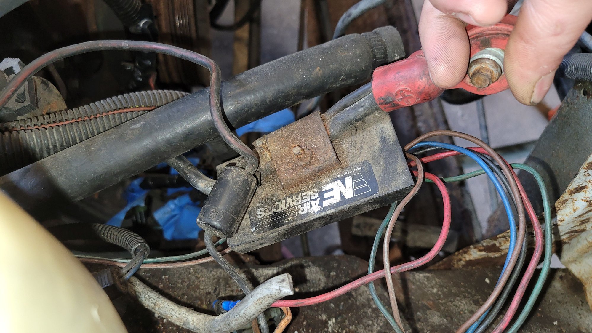

hey guys new to the forum, but have trolling for many years. I have a 86 camaro tpi that I am switching to carb and cleaning up all the old wiring.
does anyone know what this box is for? its located my the battery and plugs into the drivers side harness. I tried looking it up with no luck. It says NE air services on it. Thanks in advance.

Now, unfortunately I can't tell you what that is, I haven't a clue......
BUT !
I can tell you what it isn't. It is not a factory installed GM component, it's some kind of aftermarket device for doing, , , , something.

Could only make a WAG, which wouldn't help you.
Try tracing out the individual wires and compare what you find to the car's factory wiring diagram(s). Seeing where they go will provide some clues before you remove that thing and subsequently possibly keeping the car from running.
Old Jun 14, 2022 | 07:59 AM
Posts: 28,025
Likes: 2,496
Re: What is this?
Looks rather like an alarm.
Get rid of it. Trace every one of its wires and repair any damage to the car's original wiring where it was hacked into it.

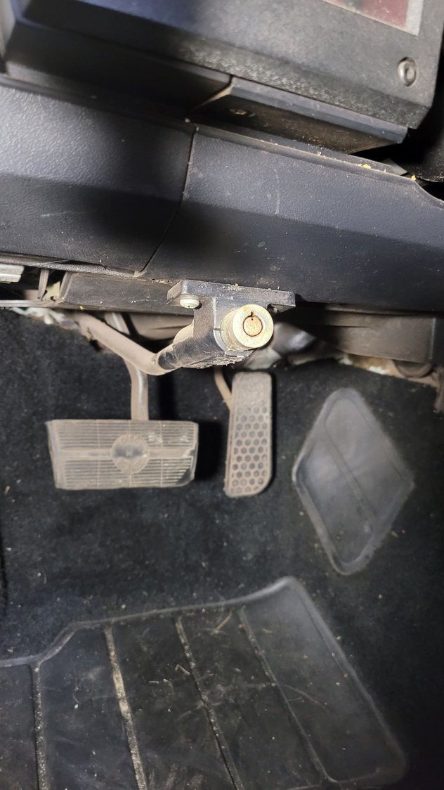

Z loc inside car

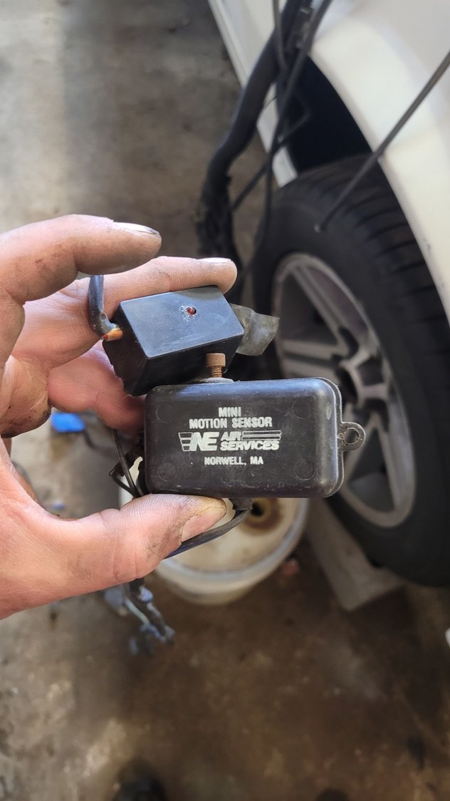

Motion sensor and security light
Ah ha.. found out what it was, a old alarm system. Traced the harness which I thought was a factory one and it lead to the drivers side fire wall. That's where these sensors were located. After that I traced a wire scotch locked to my ignition wire on my distributor connections. So that key armed the system, which activated a motion sensor and also killed the ignition.
