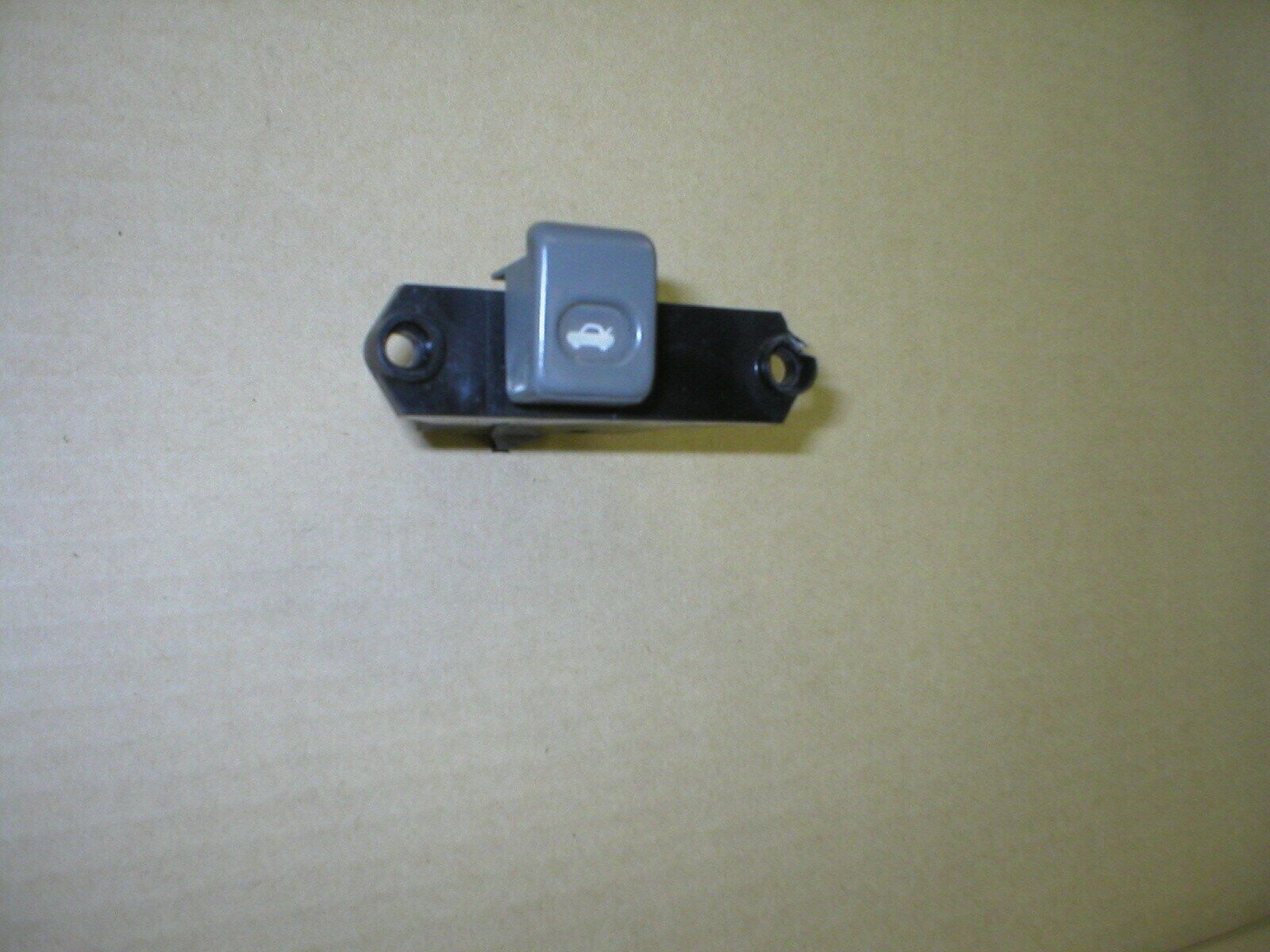

Your car has a working hatch motor but there's no release button on the dash?
The bottom ledge of the 85-88 Firebird dash bezel has spaces for three switches: 1) GAIN switch for the subwoofer system, 2) rear defogger switch, and 3) hatch release switch.
When such an option was not installed on a car, then a blank filler piece filled the space for the switch. But it's possible, even likely, that the harness and connector were installed anyway. Does your dash have a blank filler piece where the button should be, or is there just a hole, maybe where a button used to be?
Here are pictures I saved of a button listed on ebay right now. It takes four wires, so the four-wire connector you found in your car is probably it. And since you have the motor and it works, then you probably don't have to do anything except plug a button into that connector.

It should be already wired to the connector under the dash. Just plug it onto the switch.
