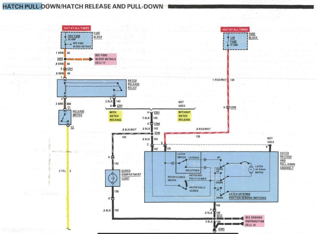

I am sure I have seen a schematic on here at one time. The positioning of the switches is pretty important. Give Lon a call at Top Down Solutions, they have all the parts you need, Lon is very knowledgeable. https://www.top-downsolutions.com/hatch-pull-down-items

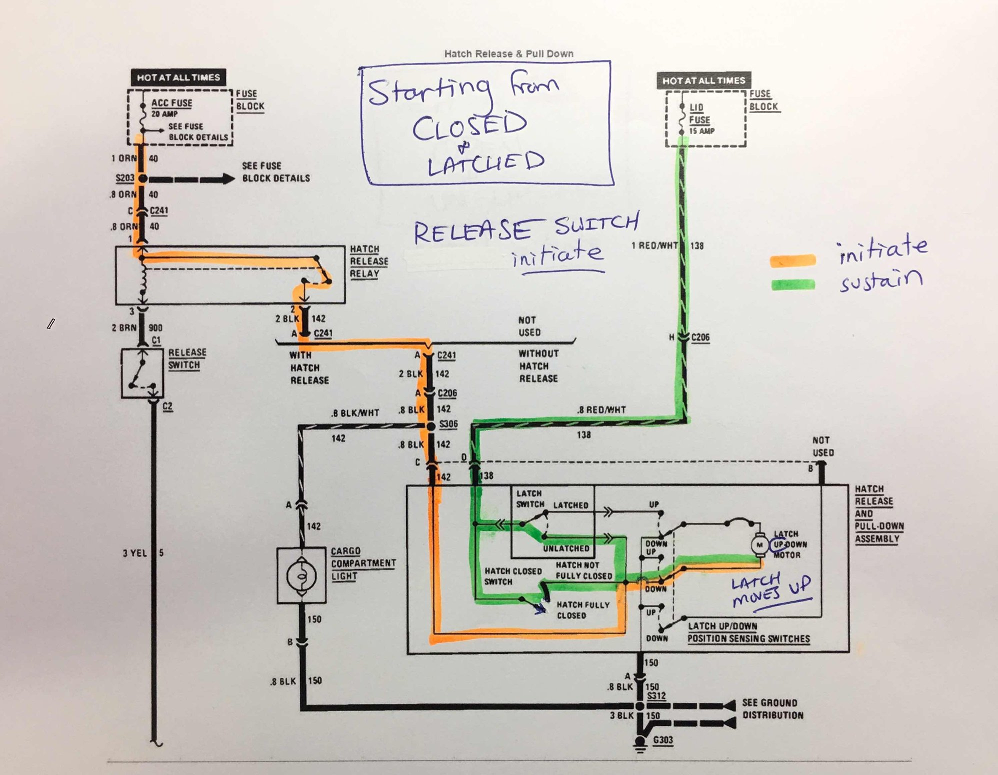

Forgot I saved a lot of the info when I went through rebuilding mine a few years ago. Here is a dump of what I have, hope it helps.

@Bow_Tied really helped me with the handwritten notes about initiate and sustained.
Evidently, the key switch will bring the "latch" limit switch all the way to unlatched.
So, what I need to do is find a way to get the solenoid to do the same thing.
It is probably not extending far enough to get the latch switch all the way to unlatched.
I will try this as soon as it stops raining here.
I will let you all know the details of the solenoid adjustment, (If it can be adjusted?), if it works or not.
