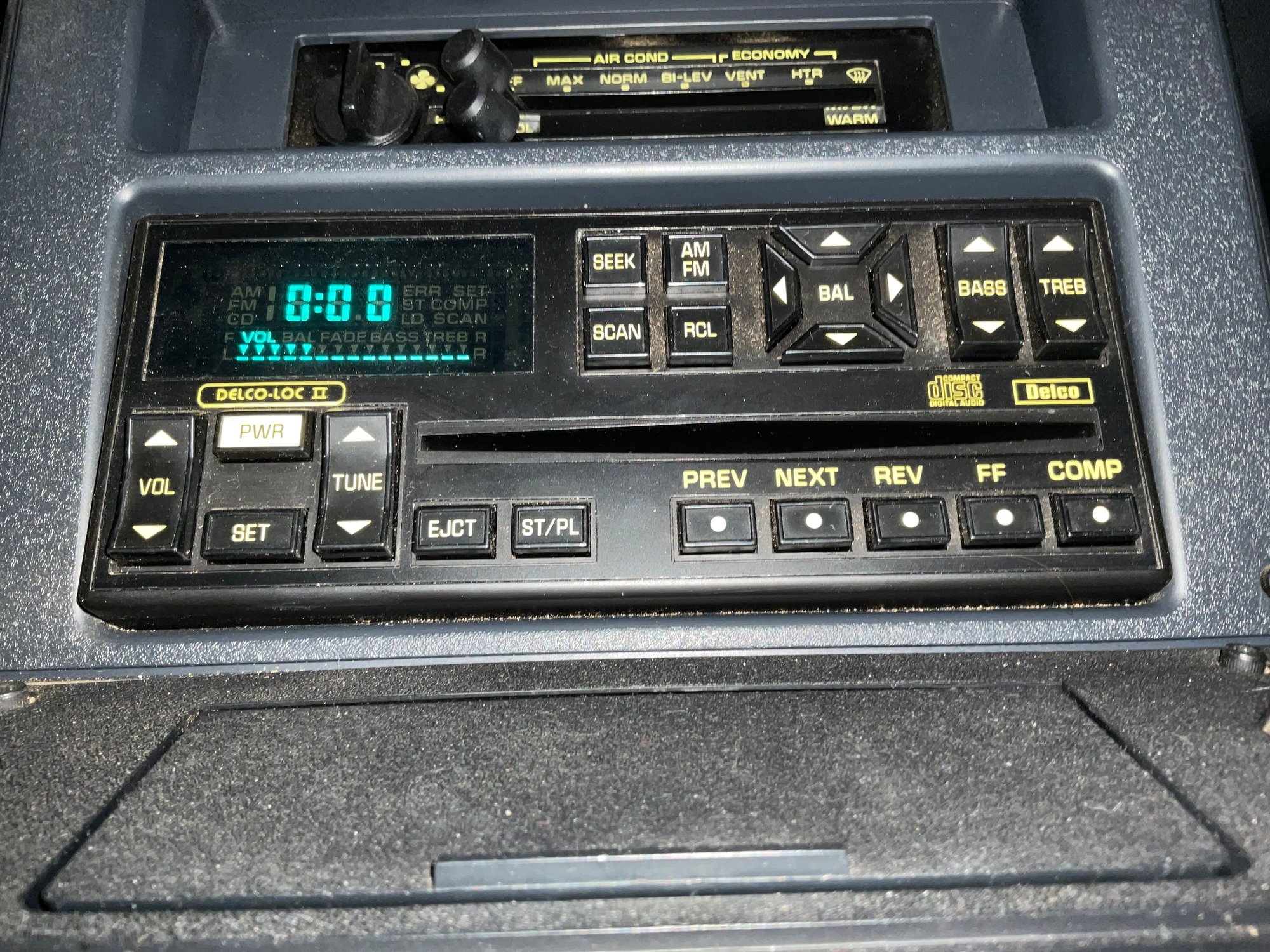

Hi all.
I have a 1992 Z28 with only 3300 miles on it.
I just purchased the car so I don’t much history on the car.
When I try to turn on the radio it only shows the display in the picture attached. No sound though the speakers and can’t change any station. I’m thinking it’s locked out as possibly the battery died on this car at some point. But I don’t know anything about this system.I removed fuse and waited 1/2 hour and put fuse back. Still same issue.
Any help would be greatly appreciated!

Re: 1992 Z28 Delco Loc 11 stereo issue.
That doesn't look to be actually locked. The display is showing the time display. Should see "Loc" if it's been programmed and needs the code to unlock. But in case it is locked I'd search the car over for a cheat sheet or something noted in the owner's manual that the previous owner used. Otherwise maybe a dealer tech will spend the time to pull the code.
Thanks Tom3.
I think you’re right that it’s not locked. Maybe the radio is just on its way out.
