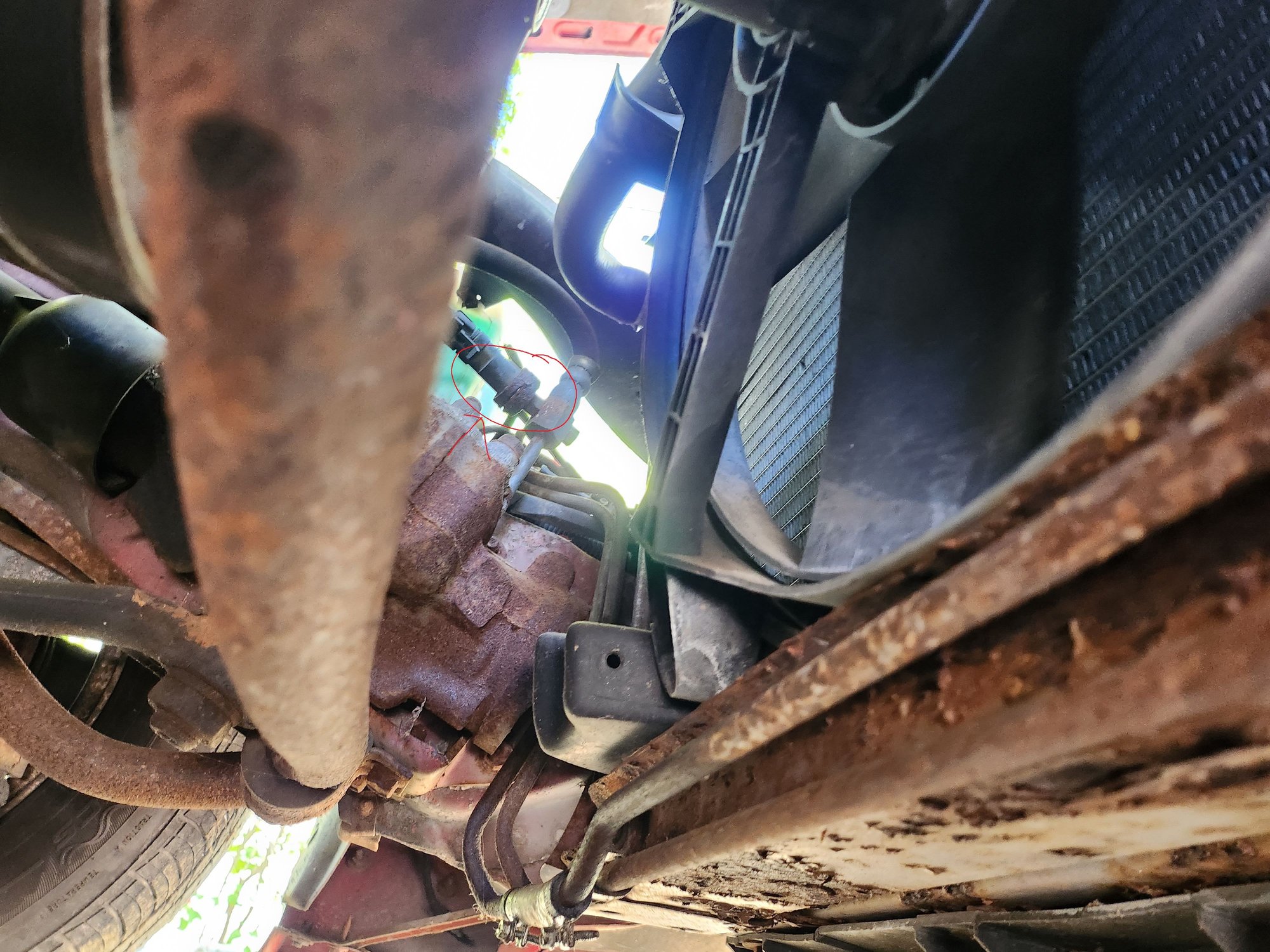

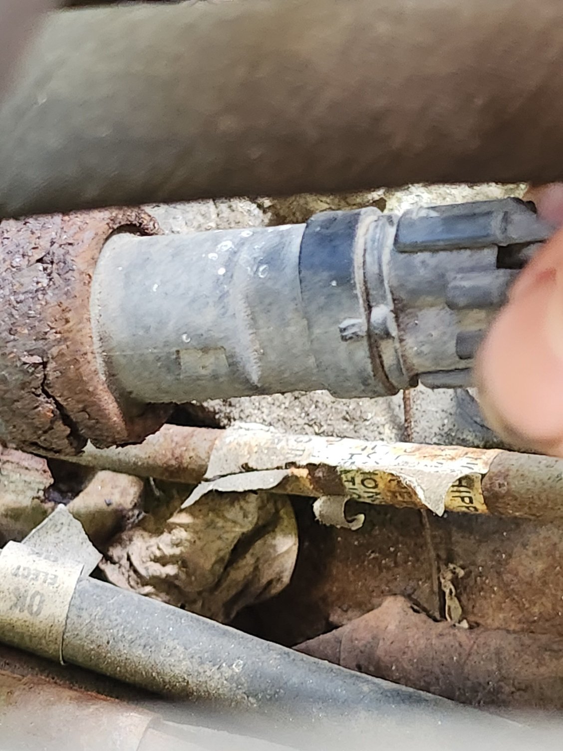

My headlights are I believe some OEM replacement, they do have halogen written on them, but they are not that bright. Also this might sound dumb but I have never known if this car has highbeams. I don't know if mine don't work or what but there is only one setting which is on an off at least for me.
What is this part I have no idea, but it definitely needs to go. The part is located on the drivers side.

Hi Jacob, That is the power steering pressure switch. It's function is to "tell" the ECM when there is an increased load on the power steering system (wheels turned to full lock, for instance) which will allow the ECM to keep the engine's RPM steady despite the increased load on the engine. You will find it in the handy wiring diagram listed as "Power Steering Switch" in post #10. Anyway, yes that needs to be replaced pronto, when it totally rots apart it's likely gonna cause power steering fluid to squirt all over the place. Now, to answer your real question, no, unfortunately that cannot possibly have anything to do with your loss of power to your headlights problem, which sounds like a bad connection somewhere, the trick is gonna be finding out where that somewhere is. It would be helpful to try each and every electrical device, taking note of what works and what don't, this may help isolate where the circuit fault is. Lastly, as to your high beams, when you pull the turn signal lever towards you with the headlight switch on, do you hear a switch click?

Hi Jacob, That is the power steering pressure switch. It's function is to "tell" the ECM when there is an increased load on the power steering system (wheels turned to full lock, for instance) which will allow the ECM to keep the engine's RPM steady despite the increased load on the engine. You will find it in this handy wiring diagram listed as "Power Steering Switch". This leads me to a question, do you have a V6 or a V8 ? I ask because my diagrams only show it for the V6 and not the V8. Anyway, yes that needs to be replaced pronto, when it totally rots apart it's likely gonna cause power steering fluid to squirt all over the place. Now, to answer your real question, no, unfortunately that cannot possibly have anything to do with your loss of power to your headlights problem, which sounds like a bad connection somewhere, the trick is gonna be finding out where that somewhere is. It would be helpful to try each and every electrical device, taking note of what works and what don't, this may help isolate where the circuit fault is. Lastly, as to your high beams, when you pull the turn signal lever towards you with the headlight switch on, do you hear a switch click?

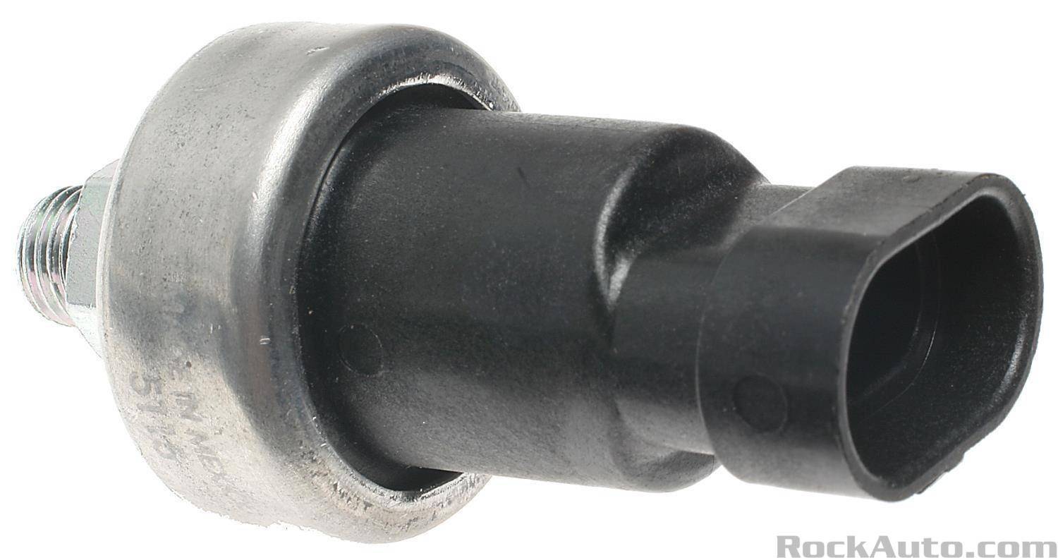

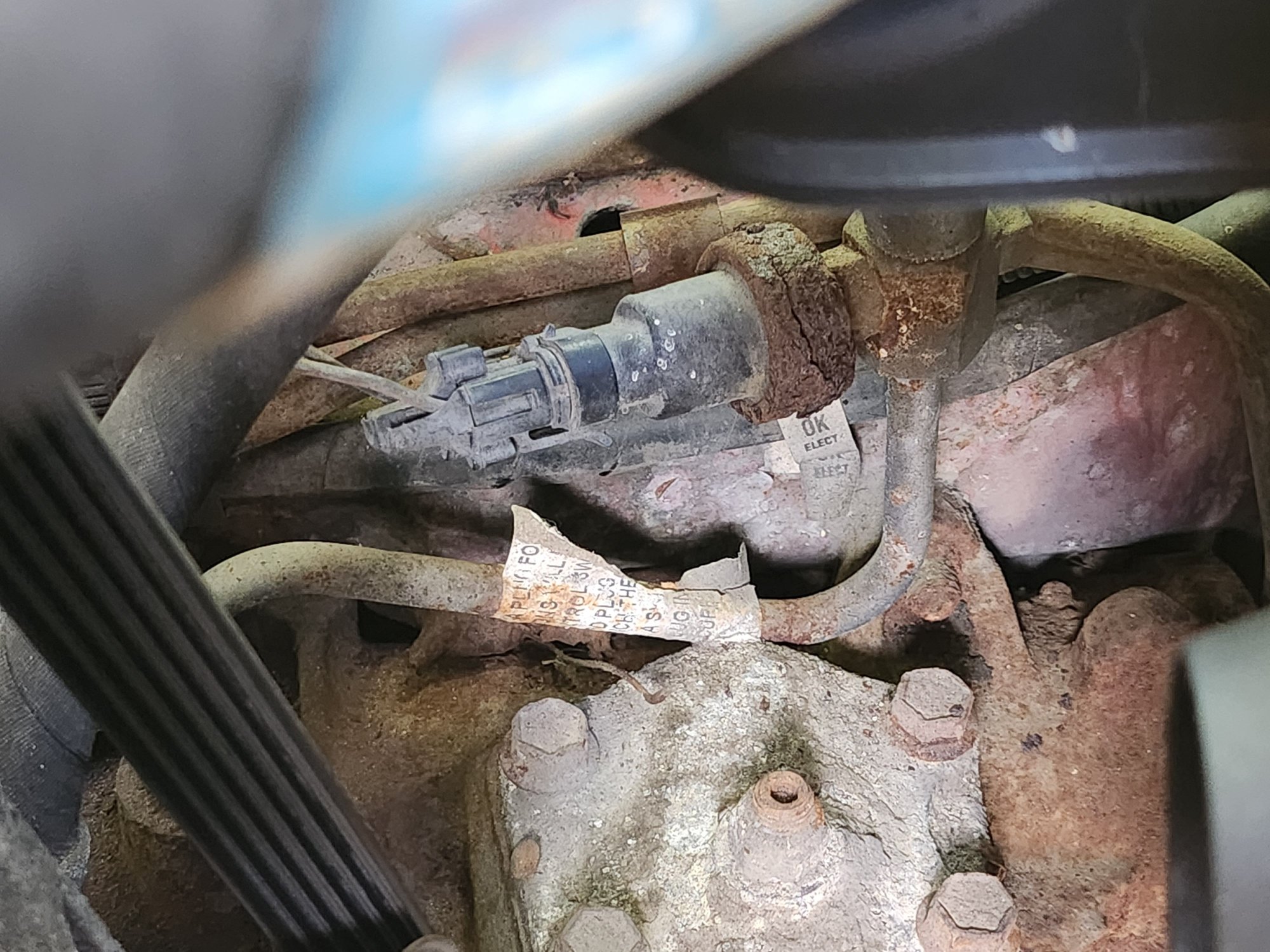

The switch the OP showed is plumbed into the power steering's high pressure line, and is not in control of the A/C that I know of, I believe it's function is to allow the ECM to keep the RPMs steady when turning the steering wheel at idle/low engine speeds. Here is a pic of the hose, the supplied block off plug is for applications that don't use that sensor, and a pic of the sensor itself.
From the look of how crusty the OP's sensor is, and with the likelyhood of the sensor crumbling and leaving the threaded end in the hose, the OP may do well to buy both the sensor and the hose when he does the repair.
