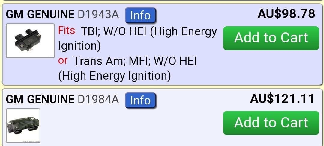

Which is the correct icm for a stock 1988 305 TPI?
I don't recall there being 2 different ac delco ones last time I ordered, maybe I've ordered incorrectly ?? Don't know if that would cause them to die quicker or not.
I would go with the D1984A, seems like the other is for TBI…it seems a lot of aftermarket replacement parts are junk, especially electrical. It used to be the only good ICMs were AC Delco or GM.
I think you want ICM: 10496048 which has been superseded to D1943A (w/o HEI). My notes on the subject are as follows:
https://www.thirdgen.org/forums/diy-...ml#post3775917
https://www.thirdgen.org/forums/diy-...ml#post3924372
http://www.gearhead-efi.com/Fuel-Inj...odule-failure&
ICM stamped '369' (AC Delco D1943A, GM 19179578): First used on the 1985-1993 Chevrolet Caprice with the 9C1 RPO Police option. This ICM does not retard timing starting at 3500 RPM, but provides 2 degrees additional advance from 4,000 to 5,000 RPM and a total of 6 degrees additional advance above 5000 RPM. GM replaced the "048" ICM with the "369" ICM. The replacement may not have "369" printed on it. The "048" was discontinued so GM felt like there was no need to differentiate between the two. If the AC Delco D1943A module does not have "369" printed on it, look for the GM part number 19179578 burned on the edge of the module. The 19179578 8-pin ICM was originally for the 9C1 Police Option in a Caprice. In 1989 GM made the AC Delco D1943A ICM (19179578) as the service replacement for all V6/V8 models through 1995.
Rockauto seems to make that part listing confusing with the notes. My replacement AC Delco distributor came with a 369 ICM and it has worked great, I kept the OE 048 as a back up.
It is super confusing. I have an 048 and it's one of the things I plan on correcting when my attention comes back around to the IROC-Z.

Thanks for all the info guys. I'm going to order the D1943A module and get the heatsink to add on with it, hopefully that takes care of it for a while.
