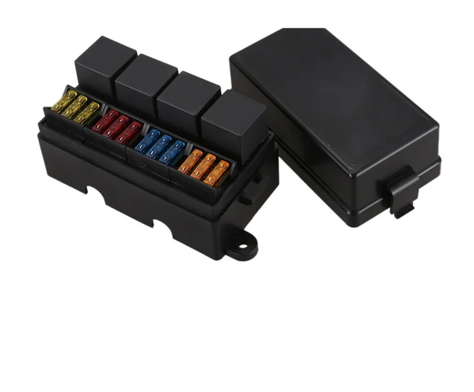

I don't know what the total current draw would be. I just know there are 4×40 amp relays that are housed in a box with fuses. I need to bring power to them but don't want to run 4 individual wires from the battery (or starter lug in this case). Haven't yet found a way to bus all the connectors in the box together...

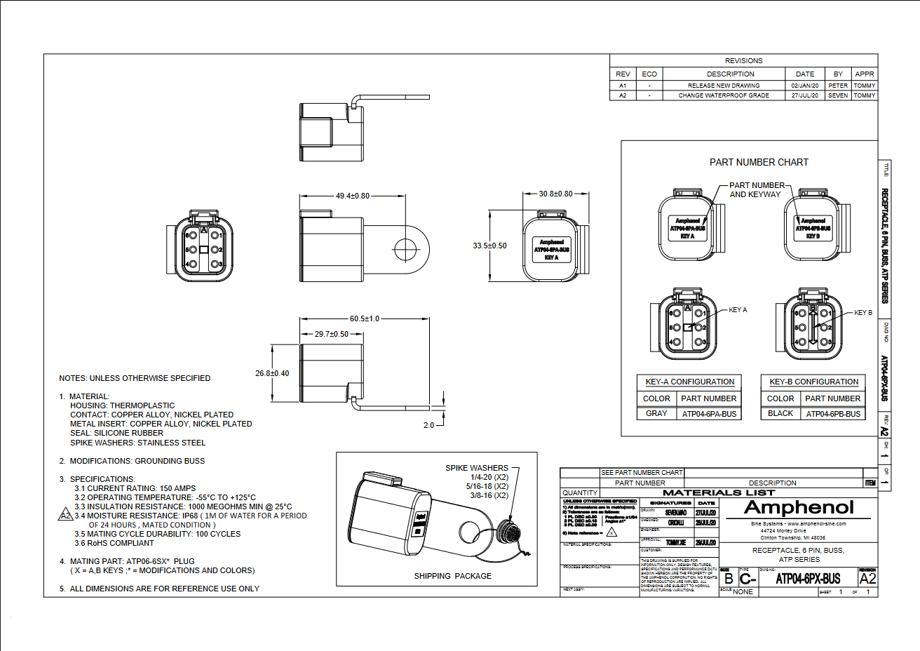

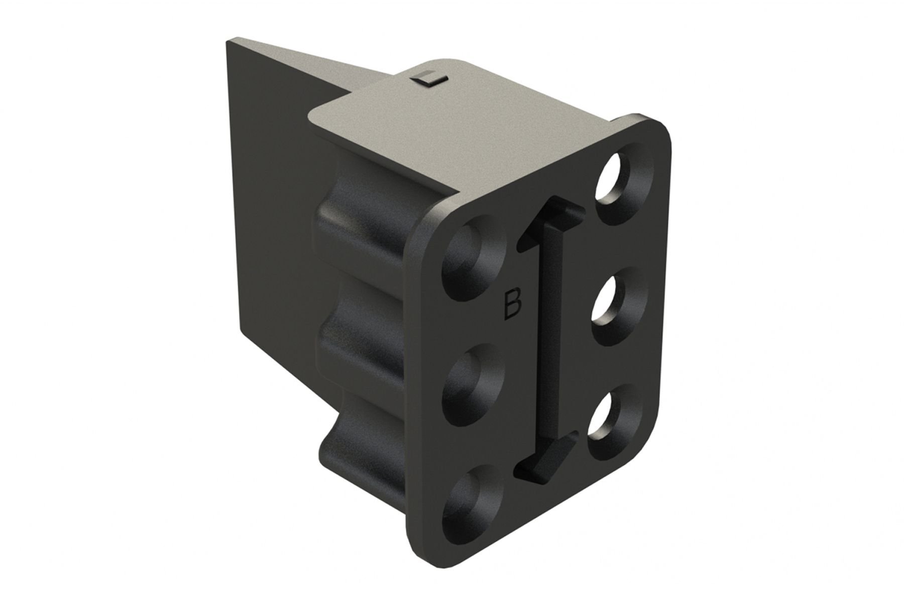

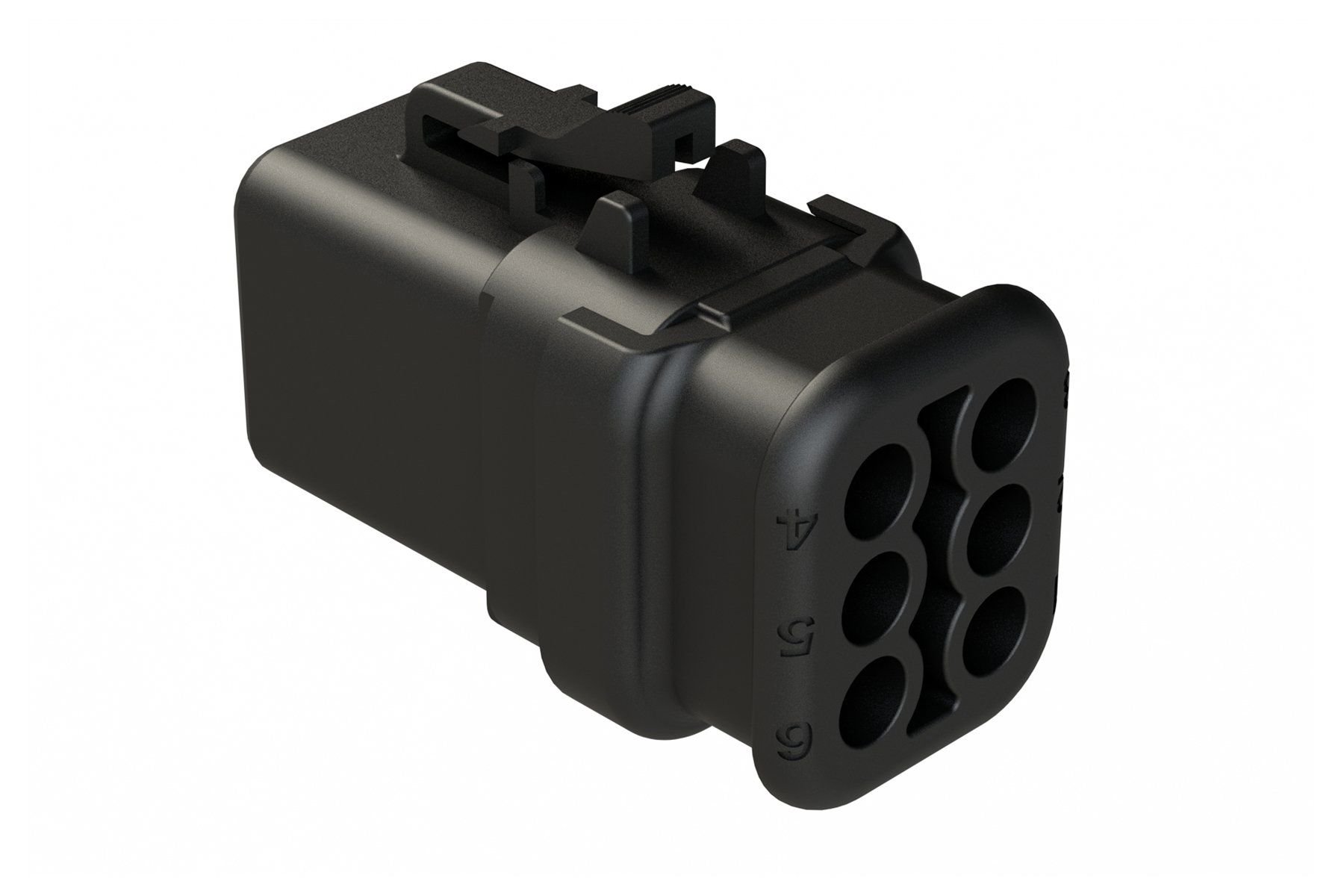

I have an sealed Amphenal Buss that you connect to a Power Cable on a Junction Stud...
You can use it as:
-6x 25A Outputs.
-3x 50A Outputs.
-2x 50A + 2x 25A Outputs.
-2x 75A Outputs.
No matter what, total Amperage Output will be up to 150A.
Mating Connector:
TPA:

I'm looking at Amphenol products and much of it looks shockingly familiar, and I am left wondering.... has TE ever invented anything on their own?
Old Sep 24, 2023 | 02:01 PM
vorteciroc's Avatar
Top Answer: 1
Joined: Jul 2006
Posts: 2,924
Likes: 803
From: 212 is up in this Bit@#
Re: Connector Recommendation?...
This is one instance where Deutsch is the original creator of the (DT/ DTP/ DTM) Products.
TE Later purchased Deutsch and improved/ expanded the Products.
Amphenol created copies, but they also further improved some of the design aspects and expanded the variety yet again.
(Deutsch does not offer the above products, but share the same Terminals DTP/ ATP).
But yes (you are correct) most of the time TE is either purchasing something or copying it.
